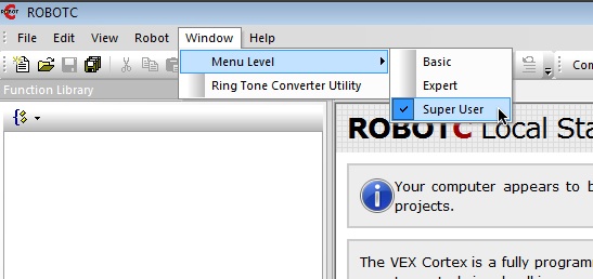

By your list, I am having trouble with step 3. Under “Download Firmware,” and “Master CPU Firmware,” the only options we have are “Standard File” and “Last File Downloaded.” There is no “Select File” option.

  1. Use the VEXnet firmware upgrade utility, if you are getting the “MSCOMCTL.OCX” error then this often happens if you are trying to run the application under windows 7 64bit, if this happens try running the app in 32bit compatibility mode. If you already have “normal” 3.21 loaded then the vexnet upgrade utility will tell you that you that you are up to date, if that happens then power the cortex whilst pushing the config switch with a paper clip or similar, that will put the cortex into boot mode and allow you to download.
  2. Use ROBOTC to download the file, to do this you need to enable super-user menu level, that’s why you only see the two options. Then download the file C:\Program Files\VEXnet Firmware Upgrade\CORTEX_V3_21_Worlds.BIN (under XP, will be different under Win 7)
We have Widows 7 Starter, 32-bit.
How does one enable super-user menu level?
Under the window menu.
[ATTACH]5674[/ATTACH]
Thank you!
