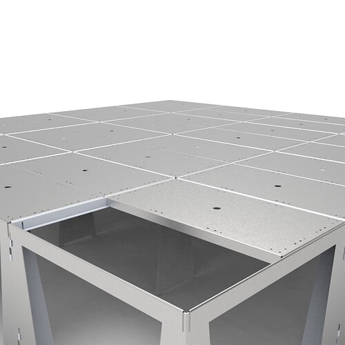

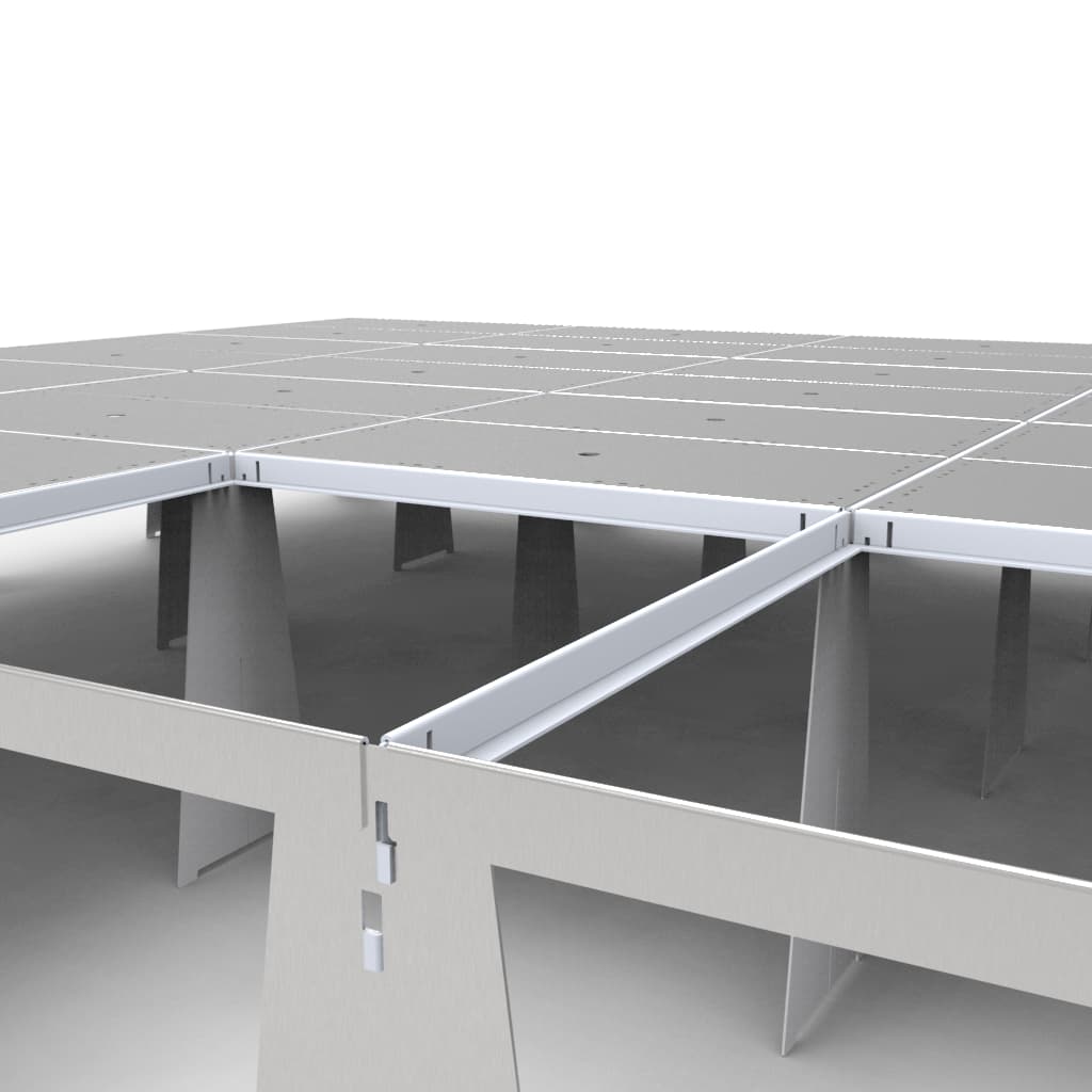

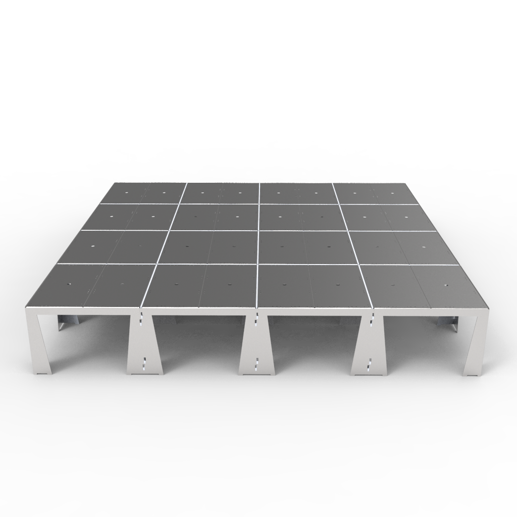

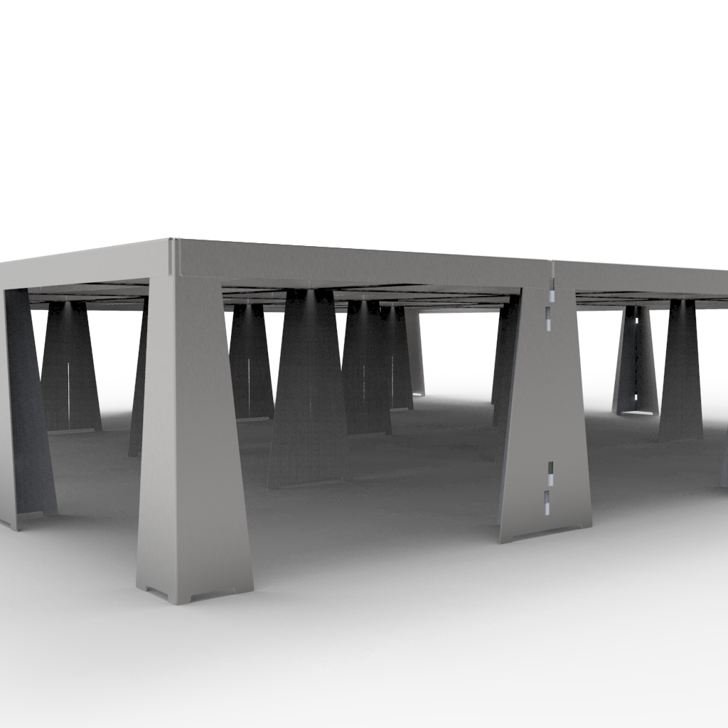

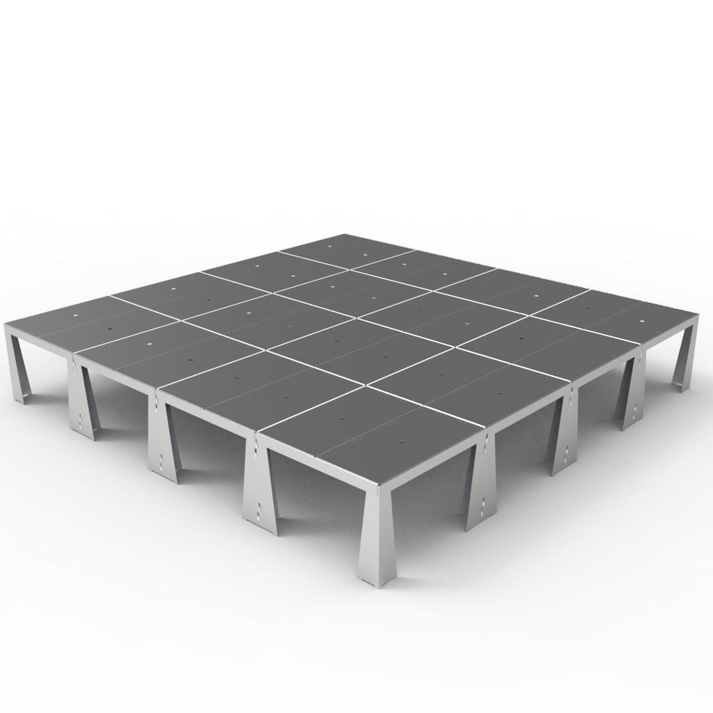

I remembered that there was a brief discussion on this a few years back, and Paul posted CAD files of the risers. They are custom designed, and produced at our in-house metal facility specifically for this need.
The Risers are made out of steel (so very heavy), and are assembled by interlocking tabs / flanges, so no tools required. They also condense pretty nicely, as all the riser stands and connection beams fit nicely into the base plates when it’s time to tear them down.
The files he posted are for a VRC set-up, but can easily be converted to IQ by removing a few parts. I don’t have any actual images of the risers, but put a couple of quick renders together so even if you don’t have access to CAD software, you can get an idea of what they look like.
If you need any other angles or close-ups, just let me know.
