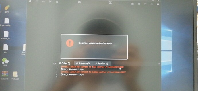

VEXcode could not launch backend services
VEXcode could not launch backend services and I cannot interact with its interface at all.

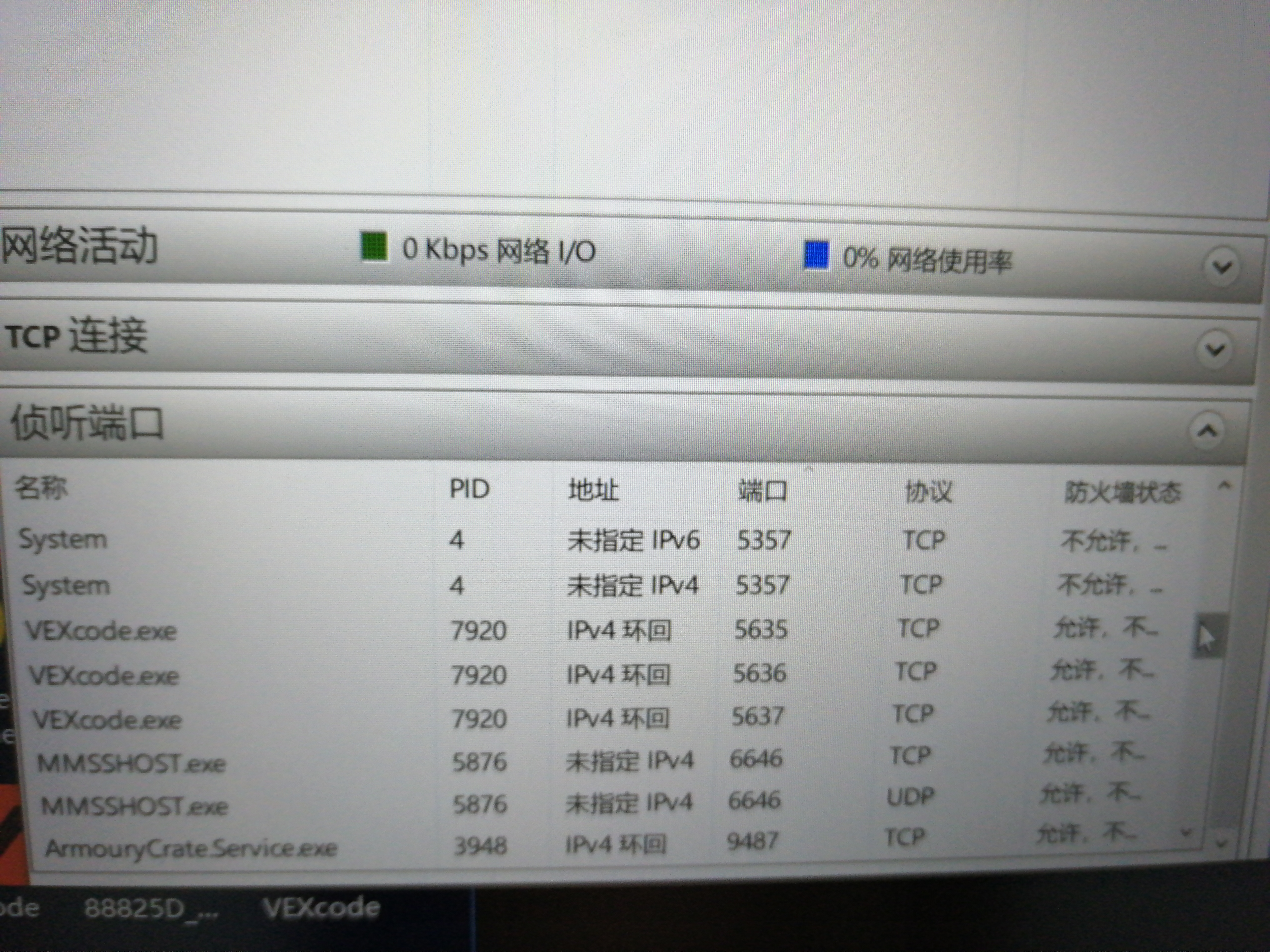

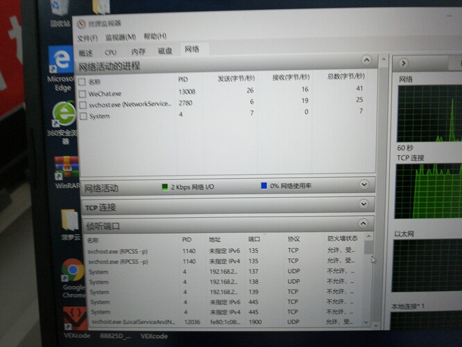

Can you run “resmon” on your PC, go to the network tab at the top and then expand the listening ports. You should see something like this.
VEXcode currently uses ports 5635 through 5637. The “could not launch backend services” means that you probably have another program using those ports or something is blocking us from opening them.
can you get a screenshot or post the output from resmon here and perhaps we can figure out what’s happening.
15631849223426393495151296385767
15631849891771999592847546729453
in port 5635~5637 the firewall status says “allowed, unlimited” or something like that. I’m not so good at translation

VEXcode 1.0 will have a little more logging available that may help us identify the solution to this issue, to be honest, based on the information you provided us here, I don’t really know what’s wrong.
I have to connect to a network and connect to a VPN for it to run.
Is the vpn being redirected outside of China?
Yes it is. I can direct it to US, Singapore or Japan.
