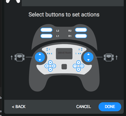

Is there a tank equivalent to the arcade method in the Drivetrain class? I am unable to figure out how to use tank controls without configuring each motor separately without the Drivetrain class.

If you are using graphical configuration, then just configure the controller for tank controls.
if you have instantiated the drivetrain in code (or don’t want to use graphical configuration for the controller), then there is no member function for tank control in the drivetrain class. Just send controller joystick values to the left and right motors (or motor groups).
