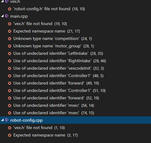

When I try and download my code to our robot i keep getting all of these errors saying ‘robot-config.h’ not found and ‘vex.h’ file not found either.

heres the Problems that it read.
did you delete or move vex.h ? Does the program build ?

Also @mw_7838 could you post a picture of the sidebar in VEXcode?
It does build but I never moved the vex.h file
You are missing a few header and cpp files like jpearman said. I would make a new project and copy over the old code to main.cpp
Thank you. I made a new project and it worked. I had use a flash drive.
