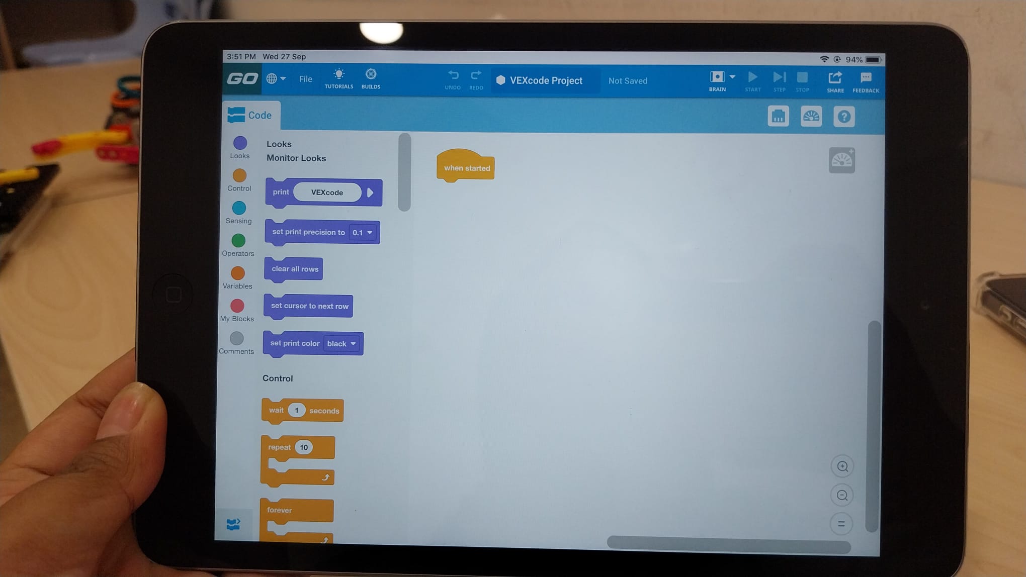

Hello all,
I downloaded the Vexcode GO app however I am unable to access the drive mode, could anyone help me with it?
I have attatched a picture below to show
thanks.
Hello all,
thanks.
Is your iPad running iOS 12? If so, we do not support the Drive interface for VEXcode GO on iOS 12. There are several limitation in iOS 12 that prevent it from working correctly, that we are unable to work around.
