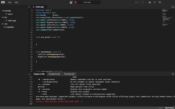

Im getting this error when I try to compile the code, any help?20%20PM
Honestly if there is nothing wrong with your code, then save and restart VEXCode. This happens every so often for me.
Doesn’t work
20 characters
I guess then try and find something else wrong, or transfer your code to a new project.
does a newly created project compile ok ? Did you change anything in the makefile or files in the vex folder ?
I moved it to a new file and it works now. Thanks!
