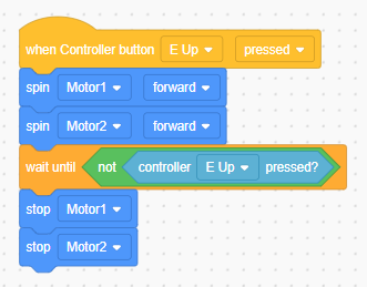

Is there a way to assign one button to move multiple motors when programming the remote using the vex code blocks? I haven’t been able to find a way to do this?
This would be best asked in a new thread, but there is a way.
IQ is diff than vexcode. Also, it’s an if button is pressed move motor, else stop motor
