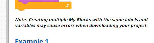

The My Blocks dosn’t have a “and don’t wait” option. Would the following be the difference between a blocking and non-blocking forward?
The weird names are because of:
You could pass a Boolean flag that had an if/else condition for “and don’t wait” optionality.
You can have parameter names be the same in each my block, you just can’t have the block labels AND parameter names be the same or else the compiler will get confused. We’re working on making more improvements to handle that situation as we move forward.

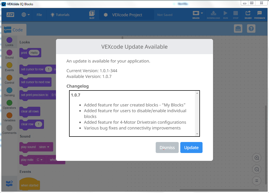

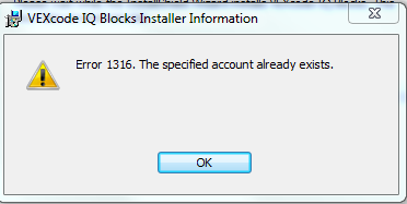

I get the following error when I try to upgrade:
any suggestion on how to resolve?

Regarding the installer issue
  • Are you using the EXE installer or the MSI installer?
  • Do you already have a version of the application already installed?
  • Did you try restarting the computer?
  • Is this on a manged (school) computer?
I have a lower rev installed already. When I start the program, I get a prompt to update the SW to latest rev. When I first did the install of the initial version, I used the msi installer.
yes
essentially the installation is not completed. The next time I start, I have the old rev running (even after restarting the computer)
home computer
I am tempted to uninstall and reinstall a fresh copy, but I am worried to have an install problem again and end up with nothing…
Thank you for the information.
The error you are encountering indicates that the installer is getting confused about what version is installer or is being installed and thinks that you are trying to install the same version again. Since this is the case, uninstalling the existing version should fix your problem this time, but I would like to try to understand what is causing the issue in the first place to prevent it in the future.
Do you remember how you originally installed the application?
Can you please tell me what version you are currently using? This can be found under File -> About
Can you tell me what version of Windows you are running?

I believe I originally installed the 1st version with the msi installer back in September. But I had initially some issues with the microsoft .net library (if i recall correcty)… I think I was able to upgrade to a subsequent revision.
Using Windows 7
I have tried to update multiple times. Perhaps there are multiple copies of the installation files?
The issue was happening in the “registering products” phase.
I uninstalled and re-installed a fresh copy and it worked.
thanks!
