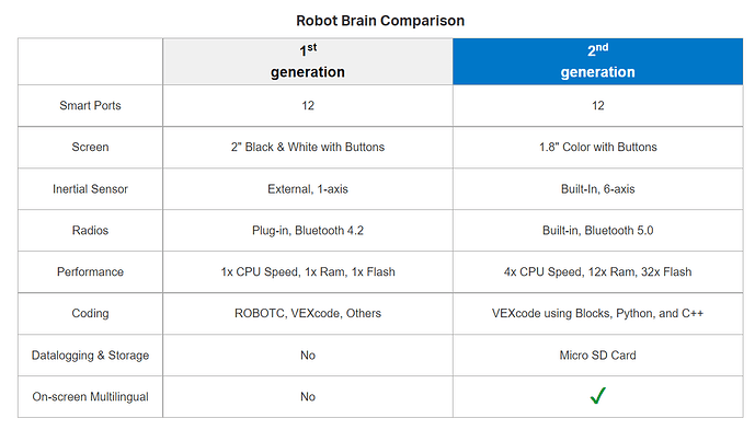

I may have gotten a 2nd gen brain though because I sent my brain to vex because it wasent work I and they sent me a new in the last week so that could be part of the problem I might have to wait untill 2nd gen vexcode comes out
The easiest way to check if it is a the new IQ brain is whether or not it uses USB-C? Or any of these other comparisons.
I’m pretty sure it would be cross-compatible. Either way. Unless there is some strange bug.
It does also say VEXcode should work with it.
Ok its definetly gen 1 I will try using ROBOTC to code it though I’ve never used it before

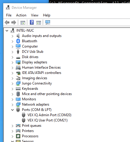

I assume you are using a PC (as you tested RobotC), check the IQ is being detected by the PC, open the device manager and look under “ports”, you should see something like this.
Two devices that say VEX IQ
If that’s missing then the issue is a driver or hardware (USB port) problem.
If they have unusual names or something then post back here.

My brain is up to date and my pc will show it under the control panel
