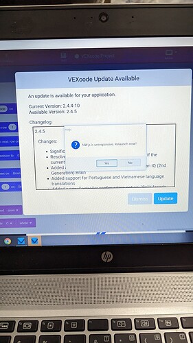

A number of folks, including me, are getting bitten by an update bug with the latest Vexcode IQ update.
Currently, if you don’t completely uninstall ALL copies (one team’s computer at school had about 10 latent installs dating back to 2021…), restart the computer, and then install from a fresh copy, Vexcode IQ keeps prompting to download the newest version.
This was a picture of what’s being displayed by one person on one of the Facebook groups. I was getting similar things, without the unresponsive error message.
This update seems to be tied, too, to the recent VexOS update. Given a lot of teams working to be updated and inspectable for regional competitions, I expect a lot more folks are going to run into this over the next few days.

Are you saying that even after updating to VEXcode IQ 2.4.5-9 (released yesterday) on a Mac it still says an update is available ?
@jpearman That’s what’s happening on Windows 10 and 11. I’ll let Sharky_do answer on the Mac side, as I don’t have access to one.
Yes it is still showing the error. Maybe I will try uninstalling and reinstalling and see what will happen.
@Sharky_do Make sure to uninstall ALL the Vexcode IQ versions before reinstalling from a fresh download; that’s the only way I could get it to work.

@EngineerMike The IQ and EXP windows update installer does seem to be broken, at least one key file is not being updated correctly. I’m sure the VEXcode team will have a solution in the next day or so, in the mean time, for those that have not updated, just dismiss the update dialog and continue using the 2.4.4 version.
I find no issues with the Mac installers
Passed on to the Facebook groups, thanks for digging into this, James. Much appreciated as always!
Just a quick update. We have update the information the update checker looks at so that you should not get the update prompts until we fix this issue. One everything is working we will push out the update prompts again.
I just pushed out a fixed set of installers. Seems that the changes we made to the application to make it load faster caused the installer to think that one of the files did not need to be updated.
I also checked to make sure this would also fix the cases where a user had a failed update to 2.4.5. you can use either the self-update system or download the new installer from the website, to install with the fixed version.
