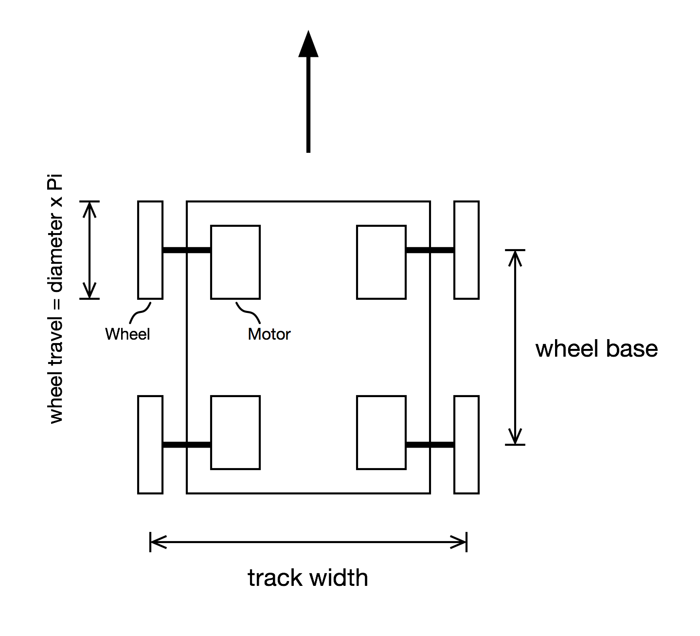

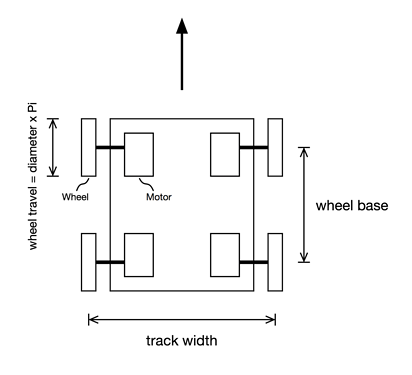

What is a drivetrain ?
A drivetrain is another high level class we use to collect together motors and some other related parameters. A drivetrain needs to know which motors are used for the wheels on the left and right hand sides of the robot. A drivetrain does not handle complex drive systems such as X or H drives, however, it will work with a mecanum wheel based drive but you would have to add your own code for strafing.
A two wheel drivetrain only handles one motor on each side, this is what the VEXcode graphical configuration is capable of handling. With more than one motor on each side things get a little more complex. The drivetrain constructor needs a motor group provided for left and right wheels, the motors also need configuring correctly which depends on how the robot is constructed and if the wheels are mechanically coupled.
The drivetrain can also use the VEX yaw rate gyro to help in performing more accurate turns. If the gyro is used we use the smartdrive class rather than the drive trainclass.
(for the advanced programmers, a smartdrive is a sub class of drivetrain, it inherits all the class member functions that drivetrain provides and then adds some additional ones to handle turns using the gyro)
The drivetrain also needs to know the distance between left and right wheels (trackWidth), the distance between front and rear axles (wheelBase) and the wheel circumference (wheelTravel).

What are the track width and the wheel base?
It was explained pretty well, including a drawing, in the original post. Perhaps read through that again.
I’m sorry. I didn’t realize. Thanks for pointing it out.
