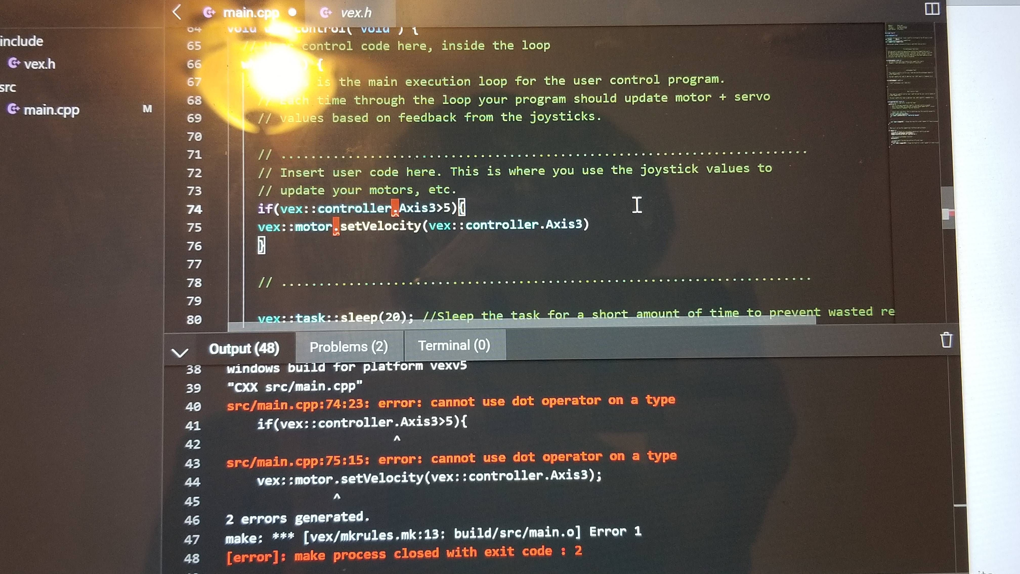

Halp I dont understand what any of this is. I just got vexcode today because I figured it was time a stopped using blockly for everything
20190907_200916
Do u mean what the errors mean or what the code does?
What the errors mean
I recommend learning the basics of C++ first.

You can’t run functions from type declarations. declare your motors like this:
vex::motor motorName = (vex::PORT1, vex::gearSetting::ratio18_1, false);
First parameter is the port, second is the gear ratio, (referring to the cartridge in the motor), and third is whether or not it’s reversed. Declare your controller like this
vex::controller controllerName;
after this, you’ve created the motor and controller objects, you can call their methods.
if(controllerName.Axis3.value() > 5){
motorName.setVelocity(controllerName.Axis3.value() / 127 * 100, pct);
You can change percent to RPM if you want, but be cognizant of the cartridge in the motor.
Also, you’ll have a much easier time getting help on the forum for errors if you copy/paste the entire error. It’s hard to read from the picture, and not all of it is in view.
In general, recipe for an easy-to-answer question is:
  • what you’re trying to do
  • what you tried
  • how it didn’t work
That is not correct syntax. Either of these is a valid way to define a motor:
vex::motor motorName = {vex::PORT1, vex::gearSetting::ratio18_1, false};
vex::motor motorName{vex::PORT1, vex::gearSetting::ratio18_1, false};
vex::motor motorName(vex::PORT1, vex::gearSetting::ratio18_1, false);
Yeah I think I need to learn c++, considering how I wasn’t trying to define a motor lol
I believe we wrote the same thing, just entered it in different ways.
If your motors and controller are already defined, then use their name rather than vex::motor and vex::controller when trying to call their methods.
