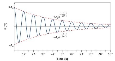

I watched your video and I am kinda new to using PID, but what do you mean when you were talking about oscillation ?

No problem! Oscillation looks very similar to this:
Ignore the equations, I just got this from Google images just for a reference. Imagine if this were a position over time graph, then this would be what the oscillation looks like. Generally the oscillation should be small (roughly within 5 degrees of desired value if used on a lift), then you will dampen it by increasing kD.
So, just to make sure I understand, your saying that as time moves on the robot’s position will come to stop when you reach the desired position and the difference between where you are and that desire position is oscillation?
I think you’re overthinking what oscillation is. Oscillation is a swinging/rocking effect near a desired value. So if I ran a PID with just kP tuned (and the rest at 0), it should go towards the position and then swing back and forth towards the desired value.
