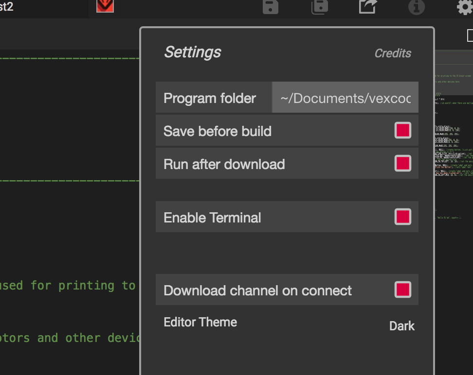

One other thing
if you are using printf via the controller, it’s best to enable the Download channel on connect setting. This causes a switch to the high speed download radio channel whenever the controller is connected, not just when we download a program.
vexcode_setting
