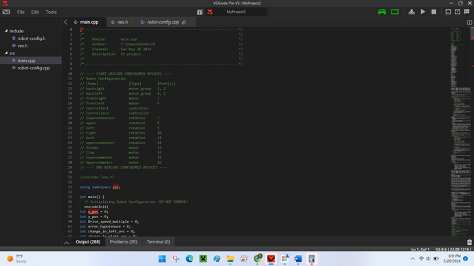

Vexcode Pro first few lines not working
I have no idea what I am doing wrong.

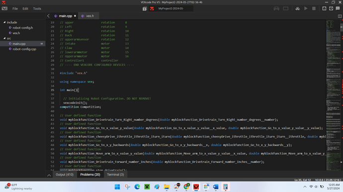

You commented out vex.h
thanks but why are the other two highlighted
“vex” is highlighted because… you commented out vex.h
x_pos is highlighted because you cannot put the function “vexcodeInit” inside the function “main”

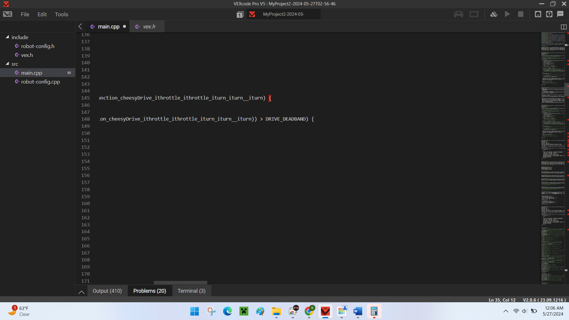

I tried to fix it by adding { at the beginning and } at the end of the code and it gave me all these errors with other {
You have a code structure issue. You keep putting code inside main that should be elsewhere. There’s also no need to keep creating new topics, it would also be better to post the code (inside code tags) rather than screen shots, that allows members to post corrections.

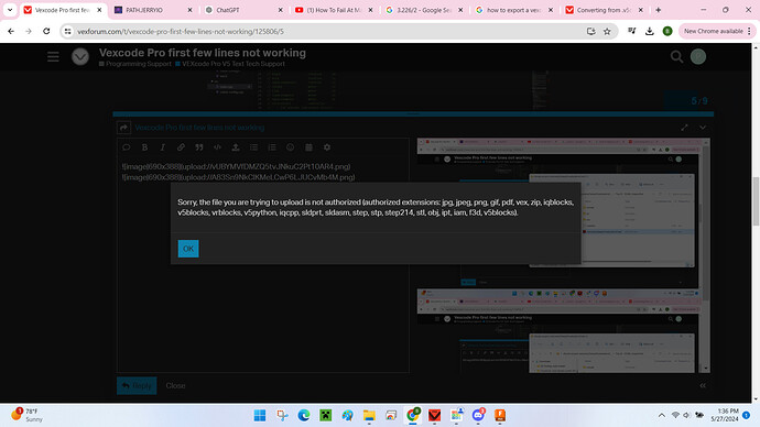

It might help to give a file if you are willing to. We can send you back a fixed version.

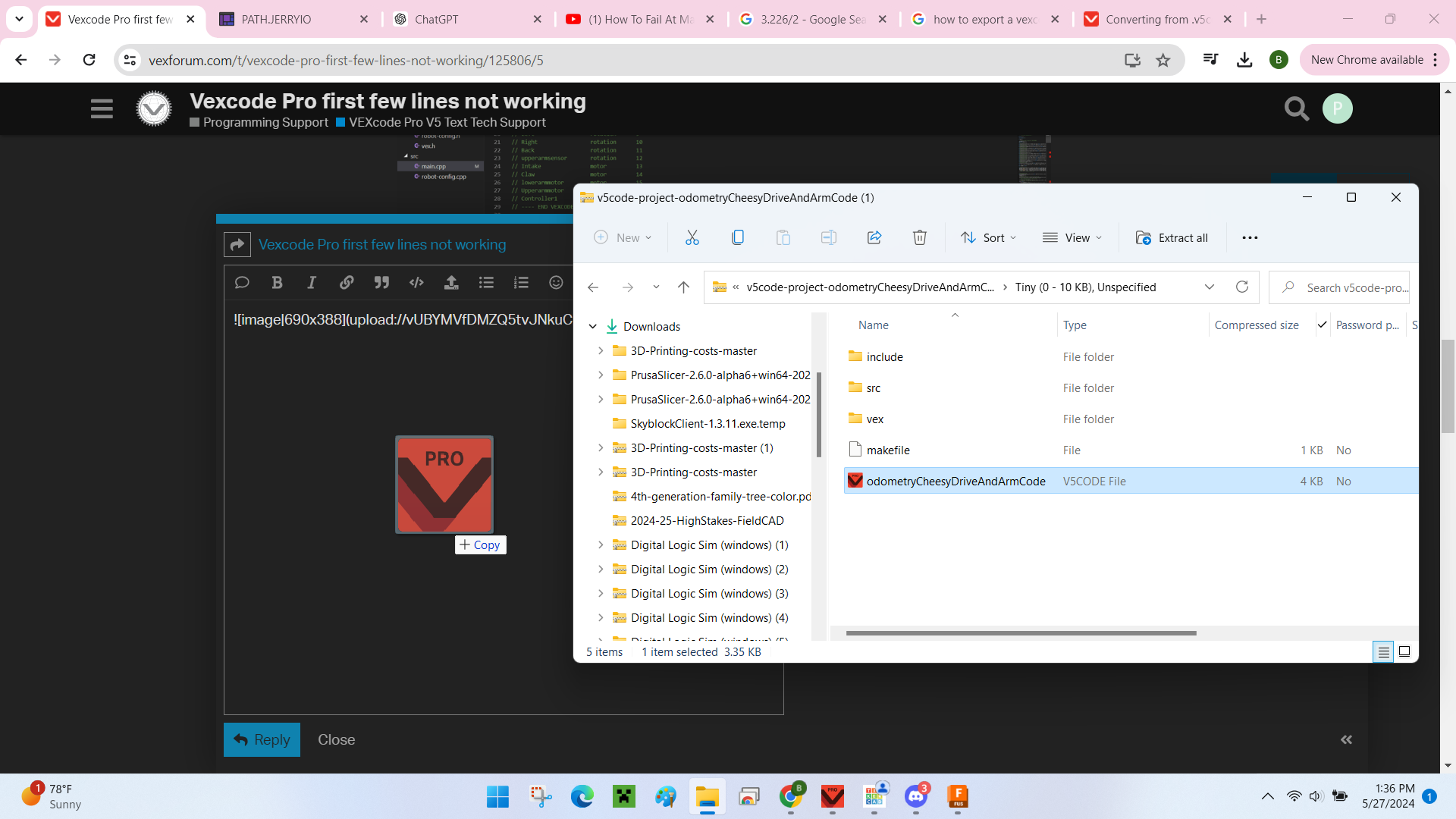

Odometry, cheesy drive, and arm (1).v5python (64.5 KB)
Well, you just posted a VEXcode python project that looks like a converted blocks project (which is generally not clear and easy to read code, good as a starting point but usually should be rewritten). Previously you were using C++ in VEXcode V5 Pro.

The v5code file you were trying to add has no source code, it’s just the project control file.
