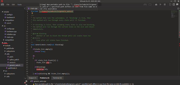

I’ve found a temporary solution to the old thread: replacing the #includes with "../core/include/file.hpp" to back out of the “include” folder and into the core/include folder. However, there’s a new problem. Initially, this seemed to fix the problem, but now I have the warning “[clang] Non-Portable path to file” on the includes, and prompts me to change it to "../Core/include/file.hpp" (note the capital C), despite the actual folder “core” being lowercase.
editor issues
This would be fine itself, but vexcode is not updating it’s index (or something) whenever I change the header file. You can see in the image “pop” is not found, despite the fact I changed the variable state_list from a std::vector to a std::queue. These errors are making it very hard to spot actual errors.
Removing the file from the project .v5 file and re-importing it works short-term, but the error comes back whenever I change the header file. I doubt there is much I can do to fix this, so I guess this is more like a bug report than a help post. But hey, if y’all have any ideas I’m open to suggestions.

I tried to reproduce on a Mac, and it seems fine. clangd on windows can have lots of issues with large projects, the lvgl VEXcode builds I have cause clangd to crash all the time, that’s mostly because we still use the 32 bit version of clangd so we can support all necessary platforms. I’ll try on windows tomorrow if I have time.
but I have no idea why it’s confusing upper and lower case versions of “Core”

I can add core/include to the makefile include path and it builds just fine, but the in-editor live error / completion doesn’t take that path into account. The ideal solution would be for the editor to read the makefile for it’s code-completion, but unfortunately it’s not done this way, and that’s up to the VexCode Pro devs.
hence the stop-gap solution for using “…/core/include”. It ~somewhat~ works, as long as the header file never changes.
Interestingly enough, I closed VexCode, cleared the windows AppData\Local\Temp directory, and all occurrences of Vexcode from AppData, did a Make Clean, and re-opened VexCode and the editor still thought state_list was a std::vector
I forget exactly the command to do it, but it sounds like you need to regenerate compile-commands.json

compile-commands.json in VEXcode cannot be regenerated as such, it does not use makefile definitions.

there is no simple way to change the include paths in the compile-commands.json file that VEXcode creates every time you save the project. You could potentially edit this file and set as read only, but I’ve never tried that.
