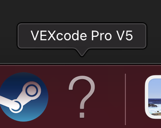

Hello, a few days ago I installed VEXcode Pro on a Macbook Pro running macOS Big Sur 1.11. After a little while I noticed it was no longer in my Launchpad. Today I reinstalled VEXcode Pro on the same Macbook and this time placed it in the taskbar. After less then 3 hours I get this icon (located below) where VEXcode Pro once was. Does anyone know what is going on?
Screen Shot 2021-01-28 at 7.33.17 PM

Are you still able to open the application with the ? icon? And do you have any sort of anti-virus running on your MacBook?
It turns out my antivirus is uninstalling VEXcode. Thank you for your help
