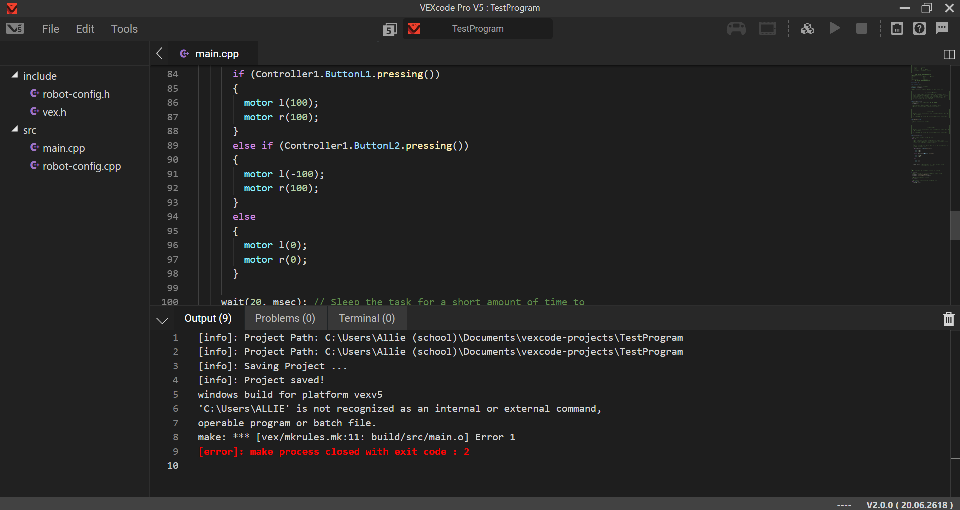

Hi everyone, first time posting. I have a build/download error that appears when I want to build/download my program. How do I fix it?DownloadProblemV5
yea, the problem is that you have a path to the project with characters the build system cannot handle. I though we could handle spaces, but “ALLIE (school)” looks like it may be a problem.
Well, it seems that path is valid for projects and it should build.
Is there anything else unusual about this system, did any files get moved ? Is it a school PC with some restrictions due to group policies or anything like that ?
No worries, got it all figured out. I think it was the parentheses in my username. it’s my own PC, so I could change it. Thanks for the help!
