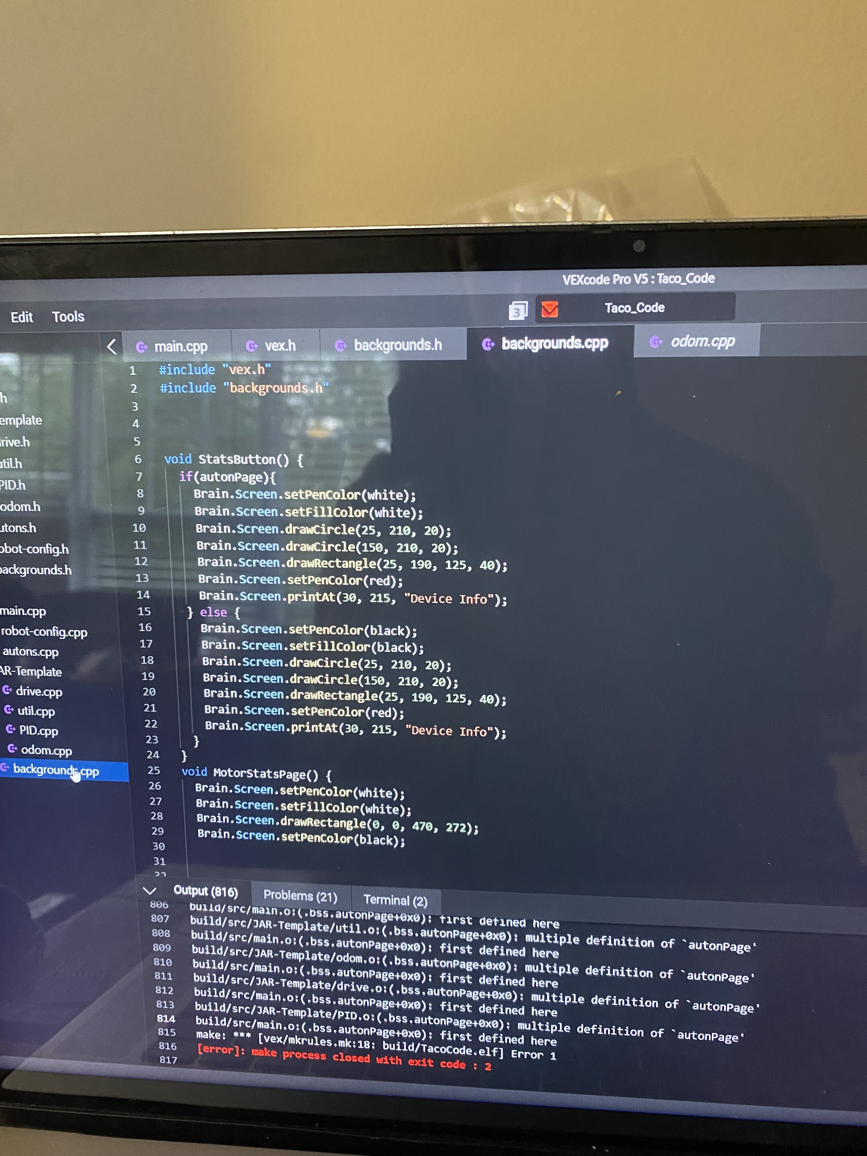

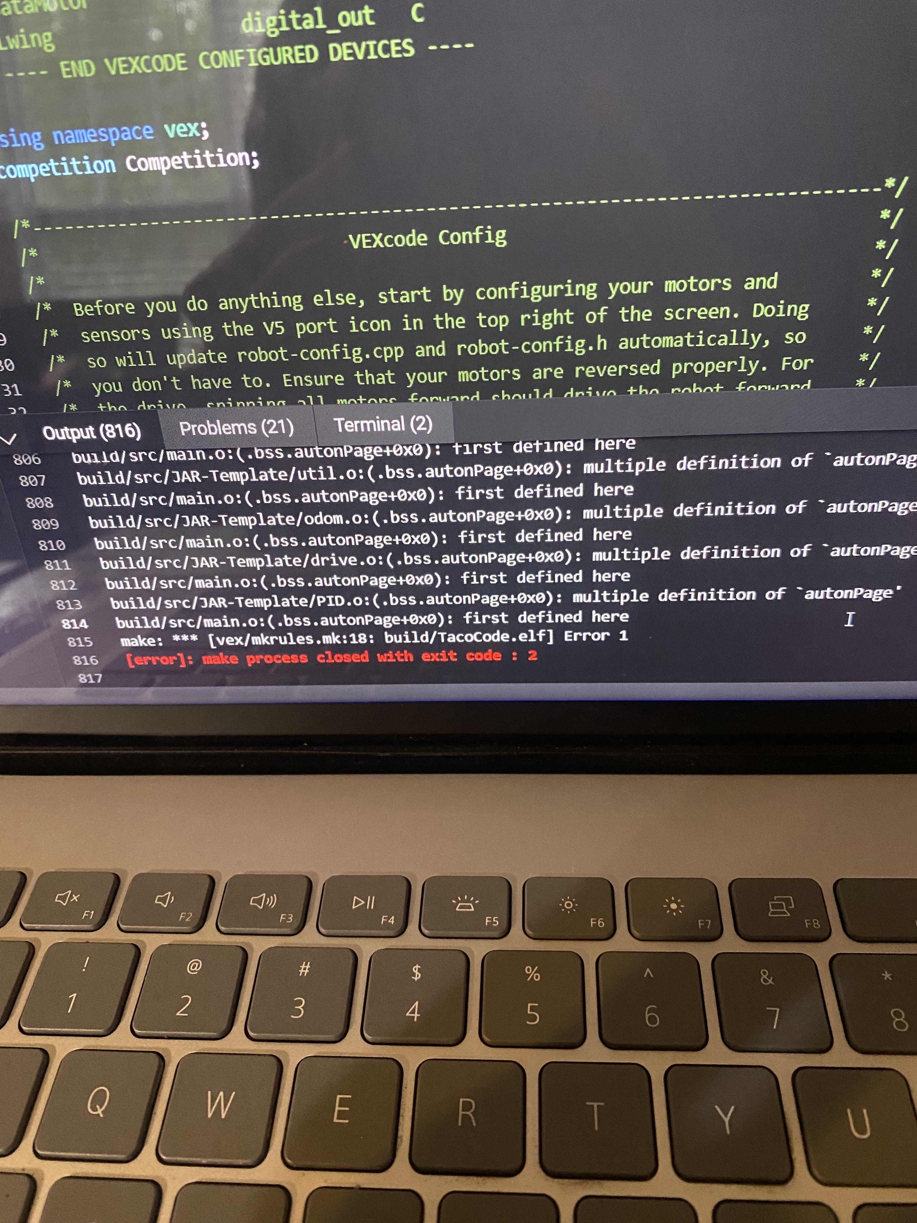

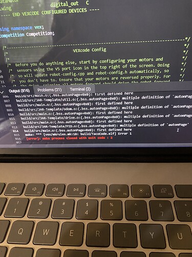

Could someone please tell me how to fix this? I don’t even know what this means or what I’ve done wrong.
It still gave me the error messages when I got rid of the overlapping inclusions, but only in “main.cpp”

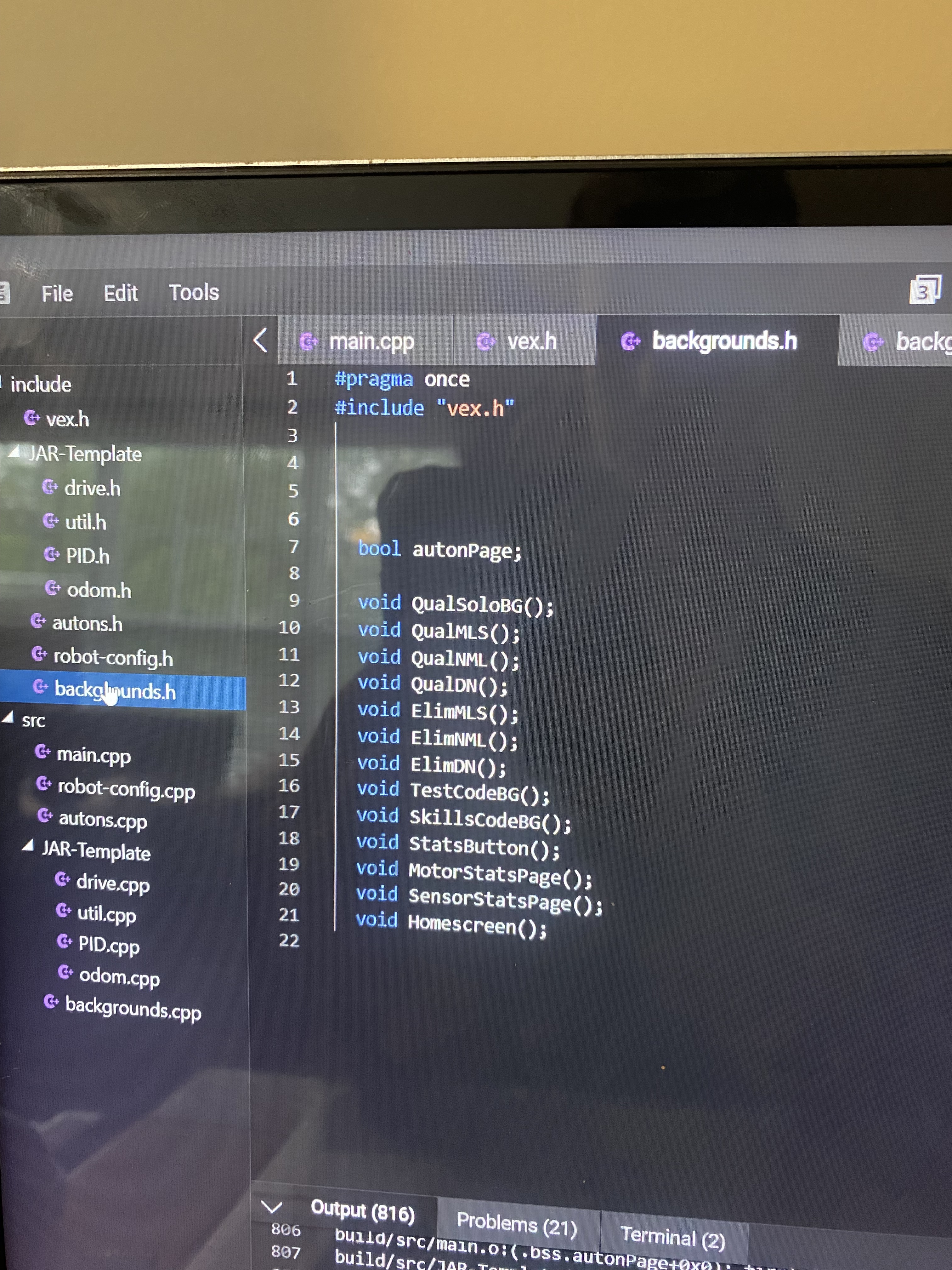

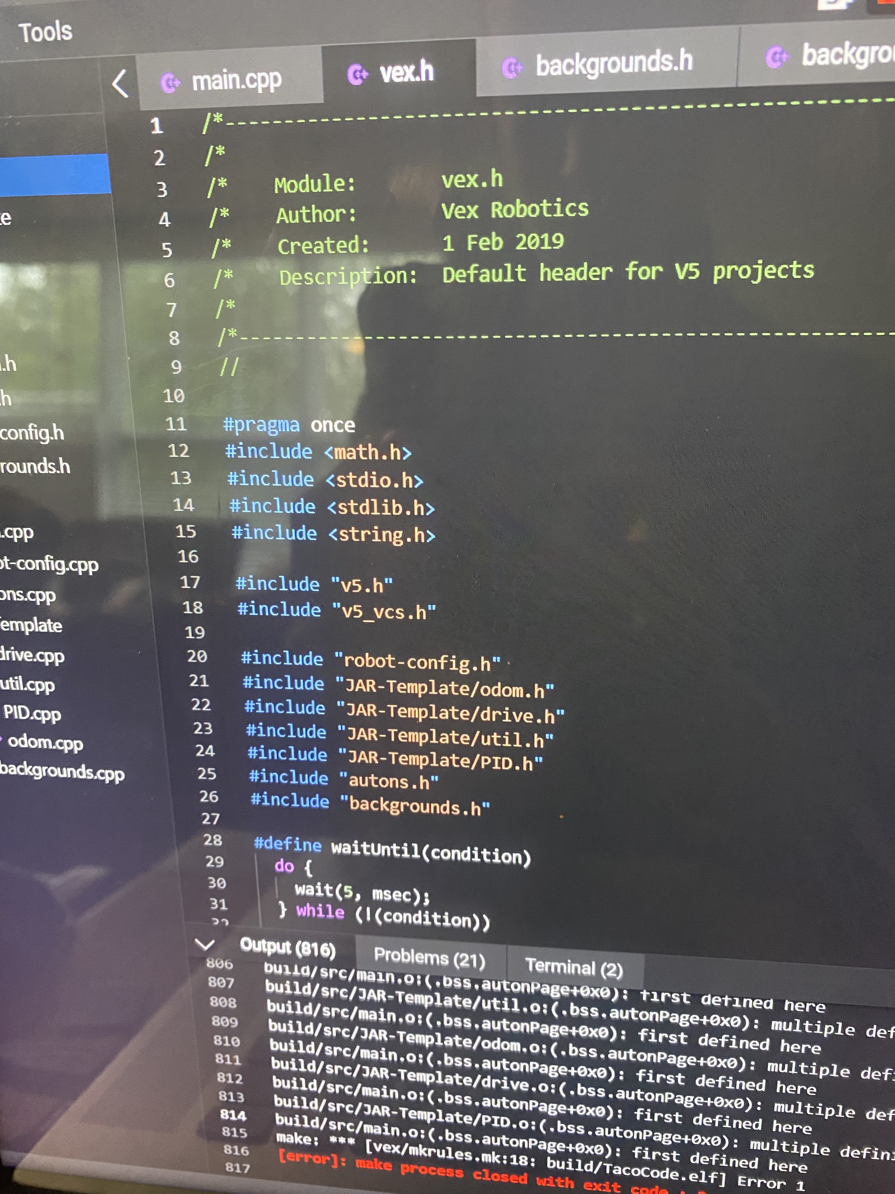

You need to declare bool autonPage in a cpp then put extern bool autonPage in the header file.
Sorry for the late response, but I did manage to figure out a solution by declaring the variable as an extern.
