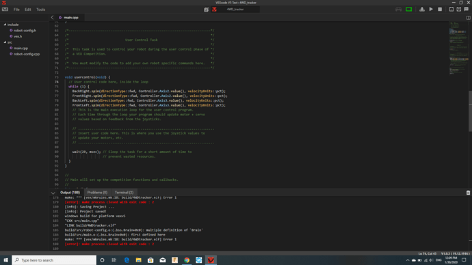

VexCode Project Closed with Exit Code 2 help!
Screenshot (29)
Help! it says exit code 2, but I don’t exactly know what that means, and there are no errors shown in my code. I have tried reading other topics, but I can’t seem to understand any of the solutions.

// ---- START VEXCODE CONFIGURED DEVICES ----
#include “vex.h”
using namespace vex;
vex::brain Brain;
vex::controller Controller;
vex::motor BackRight(vex::PORT1, vex::gearSetting::ratio18_1, true);

It looks like you are defining the brain more than twice. Double check your robot config to see if it is defined twice.
I had the same problem and apparently it was a file conflict, check if this is in the folder where the project is saved, if in the folder where your project is saved there is more than one “.v5code” file, delete the rest and just leave the original
