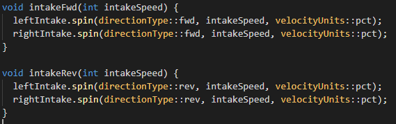

If my memory is correct “pressed” triggers a function, did you make intakeFwd and intakeRev functions?
Yes. Here are the functions:
Capture1
Btw this isn’t just a problem with the selected code segment, it’s more of a general error with the compiler.

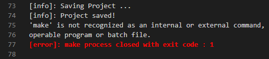

can you cut and paste here the contents of the output tab, it sounds like the compiler will not run. Are you on a school computer with any restrictions in place ?
“make process closed with exit code : 1” is not the entire error, it just means “something has gone wrong”. There will be some additional text above that line in the “Output” tab with more detail.
The best way to get help with code that won’t compile is to copy & paste your source code (remember to wrap it in [code]…[/code] tags for formatting!), as well as the complete error you’re getting, otherwise it’s much more difficult to figure out what’s wrong.

There’s the code and the error. Btw do you need the robot-config too?
ok, so there’s an issue with the toolchain.

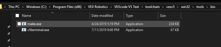

go to this location on your PC
C:\Program Files (x86)\VEX Robotics\VEXcode V5 Text
check there is a toolchain and sdk folder.
have a look here
C:\Program Files (x86)\VEX Robotics\VEXcode V5 Text\toolchain\vexv5\win32\tools\bin
is make.exe at that location.
do you have any anti-virus software running ?
Yes make.exe is there.
