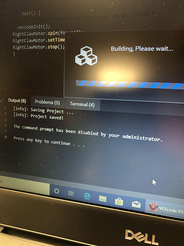

We can’t download to V5 Brain from any VEXcode platform from our student profiles b/c of network permissions. Specific problem is “command prompt disabled by admin” and then the download times out after 60 seconds and we are prompted to Abort the download. According to VEX Support yesterday, VEXcode communicates with the VEX server every time you download to the Brain and there is no way to even to this offline to avoid the communication problems.

But for @holbrook - screenshot attached. And we are using VEXcode V5 Text with Windows 10.

That does not look like it has anything to do with network permissions.
I’ll bet that if you try to run cmd.exe on that computer, you’ll find that’s blocked as well. Blocking access to the command prompt is a reasonable security-policy thing to do in a school in most cases, but it makes it pretty much impossible to do things like compile software.
Trying to compile software in a different integrated development environment as @nmh322 suggested will likely hit the same problem.
There is probably nothing you can do other than working with your IT dept. to get around this restriction.
When I was in high school we hit similar security-policy problems trying to run ROBOTC on school computers - school IT solved it by creating a new user account with the correct permissions for use by robotics students when programming robots.
Then when I took AP comp sci, we hit similar problems with various IDEs and this time IT solved them by issuing every APCS student a laptop, for use in class only, with more lax security restrictions so that it could run the Java IDE and come other software (it was a small class in a big school, so they had enough old/extra laptops already lying around to do this).
Maybe you could work out some similar solution with your IT people.
