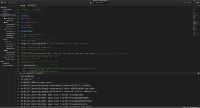

I am having trouble with VEXCode such that everything is showing no errors, but when I build it says “undefined reference to [function]” for all of the functions in the API I have constructed

I believe this may have to do with scoping, but I’m not sure. I tried moving the source files into src and yet it still had the same issue. The IDE is giving an “all clear” while the compiler is throwing errors while building. Is there anything I need to do to make this work?
Could this possibly have to do with the makefile?

Here’s what I think the problem is:
All the files included in prelude.h are just class definitions with only prototype functions. I found a weird bug in VexCode where .cpp files anywhere in the “include” directory were not compiled and files in the “src” directory that were more than one directory in were also not compiled. So a file “src/source/Calculators/pidObject.cpp” would not be compiled, whereas “src/Calculators/pidObject.cpp” would be compiled.
In short, moving all the directories and files inside the “source” directory to the “src” directory should cause a good compilation.
That’s not a bug. If you deviate from the structure of the template project, you need to modify the makefile to explain to the build system the structure of your project.
