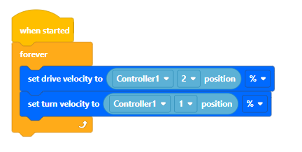

Example using a Drivetrain object:

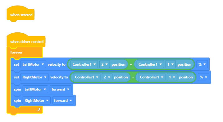

Directly controlling the motors:
This allows you to incorporate variables, functions, and different attenuation formulas to make full use of the available code.
