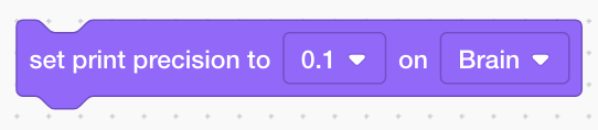

sending the motor amps to the lcd… precision is only 1 digit. Does not display anything to right of decimal like robotmesh does.

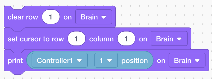

sending joystick position to lcd. Screen does not properly update and ‘ghost’ digits remain on screen.

more screen ‘ghosting’ bugs
Default precision setting is zero digits. You can choose how precise you want values to print by using the set precision block.

Printing to the screen does not automatically “clear” the line. You should clear the line, reset the cursor position, then print the value to the screen.

I think ghost issue is resolved with clear row command. Will see if I can find code examples for other problems.
