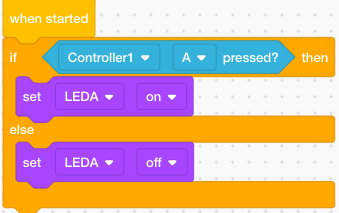

We are using a Chromebook to program and only have the vexcode v5 blocks available. How can we program a double acting pneumatic cylinder?
Treat it like an led.
Something like this:
