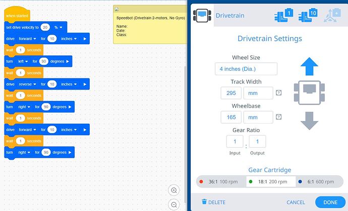

I have been trying to get the V5 clawbot to turn precise degrees with block coding. It is supposed to turn 90 degrees but every time, with multple robots, it turns well past 90, almost 120 degrees.
Here is my code and my setup of the drivetrain.
Vex V5 turning issue screenshot
ANY Help would be greatly appreciated. We have a fleet of them that my class is using to learn basic programming and robotics…
I have exactly the same issue cstone0, and my students are beyond frustrated. I have tried literally everything to troubleshoot this. It used to be that adjusting the track width could offset the incorrect turning calculations, but I believe Vex has made some additional changes under the hood as even that does not work anymore.
I brought this up in October and was told that a future software update that would separate the wheelbase and track width measurements would fix this. However, it does not. I have emailed Vex support again in the hopes that they will take a second look at their drive train calculations. I can see a variance of a few degrees without using a gyro, but being off consistently by over 20-30 degrees doesn’t make any sense.

This is a difficult subject to explain. There are multiple configurations of robot and ways to drive the wheels. The original clawbot from 2012 used four traction wheels that were geared together and driven by two motors. The latest V5 clawbot still uses two motors, but they directly drive the front traction wheels, the rear wheels are not driven and are also omni wheels. When the V5 clawbot turns, you may notice that the center of the turn is close to the front of the robot.
When using the original 2012 clawbot turning happens around a point close to the center of the robot, in this case the wheel base setting would be set to the distance between the axles, turns may still not be perfectly accurate and the wheelbase (and/or) trackwidth numbers may need adjustment to compensate for other variables such as floor material.
When using the V5 claw bot, wheelbase should be set much closer to 0, possibly even at 0, as the center of turning is almost between the front wheels, the rear omni wheels are just dragged around, it’s very much like a 2 wheel robot with a caster in the rear.
I hope this helps.
Thanks for the response – I guess my question is more about why Vex included the drivetrains and settings at all then, since the outward appearance is to allow students to put correct values in the setup boxes and use them. In this particular case, we’re talking about the “official” Clawbot, which is sold as a classroom kit and all specs and sizes are 100% known to Vex. The stem labs use this model, but the tool to program them is inaccurate to the point of being pointless, so I’m confused. Since a 2 wheel drivetrain can almost be guaranteed to NOT fall into the track width/wheel base configuration tool, why does it exist?

This is a bug in the drivetrain configuration that has been fixed and will be included in the next update available early next week.
