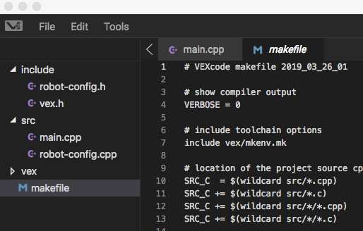

Try changing this line in the makefile. (you may need to enable display of build files in the preference dialog)
# show compiler output
VERBOSE = 0
to this
VERBOSE = 1
Then build again, paste the contents of the output tab in this topic, that may give more clues as to what is wrong.
I tryd that and it does not solve the problem
sure, it will not solve the problem, I asked you to show the build output, there should be more useful information.
How would I edit the makefile? What would I do after editing it from 0 to 1?

I’m using Vexcoad V5 pro. I edited the VERBOSE from 0 to 1 and built it. This is the message.
[info]: Saving Project …
[info]: Project saved!
windows build for platform vexv5
md “build/src” 2> nul || :
make: *** [vex/mkrules.mk:12: build/src/main.o] Error 1
[error]: make process closed with exit code : 2
