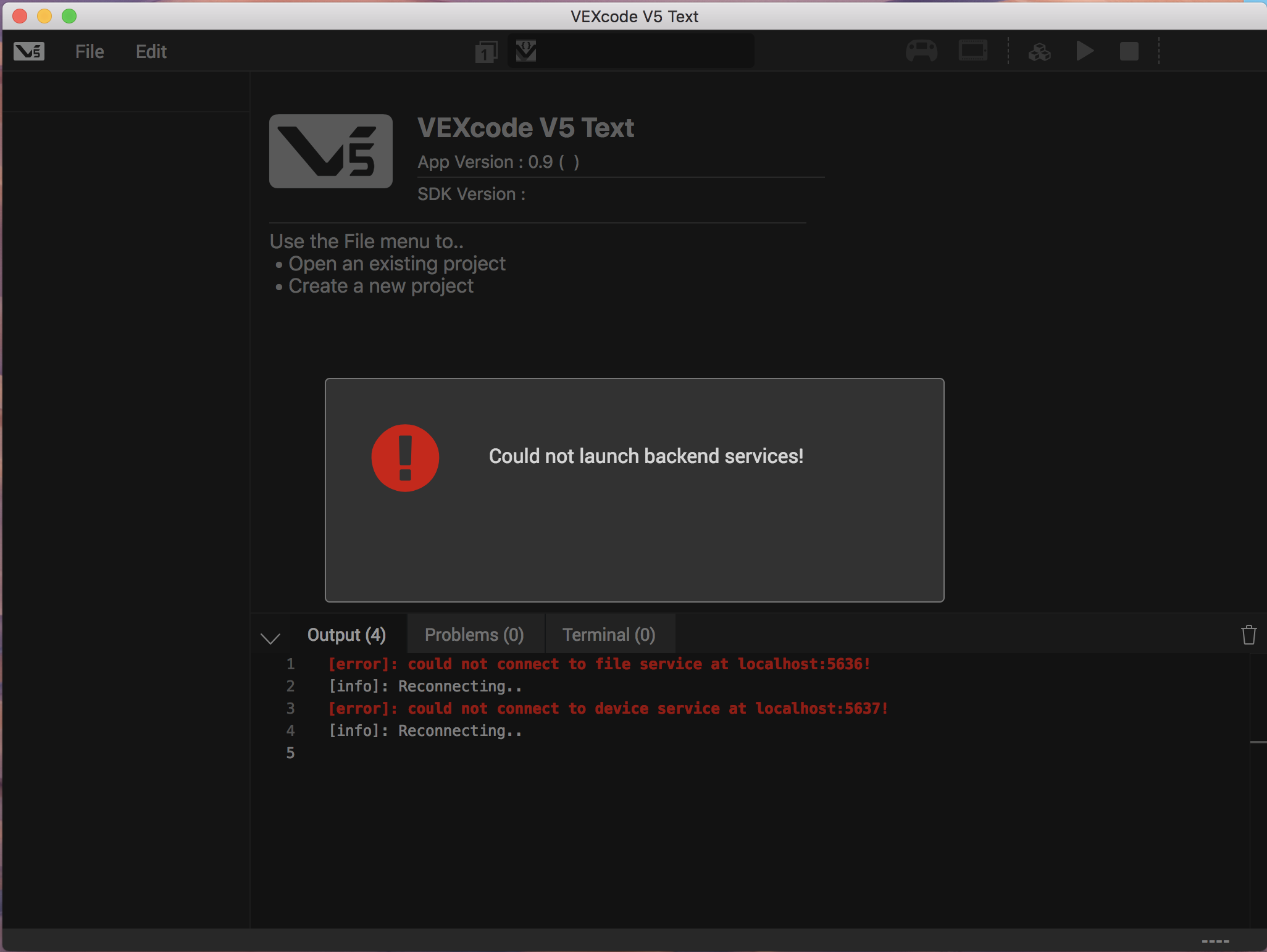

Mac user here (I know, I know). Been working with the latest version of VEXCode for a little bit (v0.9), and I’m having problems actually running the software on my computer—more times than not, a popup will appear saying “Could not launch backup services!” (image attached). Does anyone know how to solve this issue so I can get back to writing code?
Thanks!!

can you see if there any useful information in the file at this location.
~/Library/Application Support/VEXcode V5 Text/Default/logs/server.log
on the Mac’s that are not working after trying to run VEXcode.
This is from one of the non working machines…

Hm, that sort of implies some type of issue with the network, or specifically accessing your machine as localhost. Could you print out /etc/hosts for me ? In a terminal window type
more /etc/hosts
Interesting I found the host file empty on the non working machines.
I edited it to replicate the working machines…
basically just
127.0.0.1 localhost
255.255.255.255 broadcasthost
::1 localhost
And vexcode text opened :slight_smile:
Looks like I will need to do this for every non working machine but hopefully this holds up.
THANK YOU!

Oh, they were blank, that’s unusual. Just about every host file will have a default
127.0.0.1 localhost
which VEXcode needs to be able to start the servers on your local machine.
For what it’s worth, Ubuntu Server 18.04 (fresh install) for some reason doesn’t include that line in /etc/hosts and instead just produces errors that point to that line being missing. Once I added the line, the errors went away…

you need to edit /etc/hosts not server.log.
/etc/hosts needs to have this included.
127.0.0.1 localhost
thanks so much—just figured out what nylongbow meant when he said edit the file. just fixed the file, and vexcode works good as new! excited to use this new ide to write vrc code.
