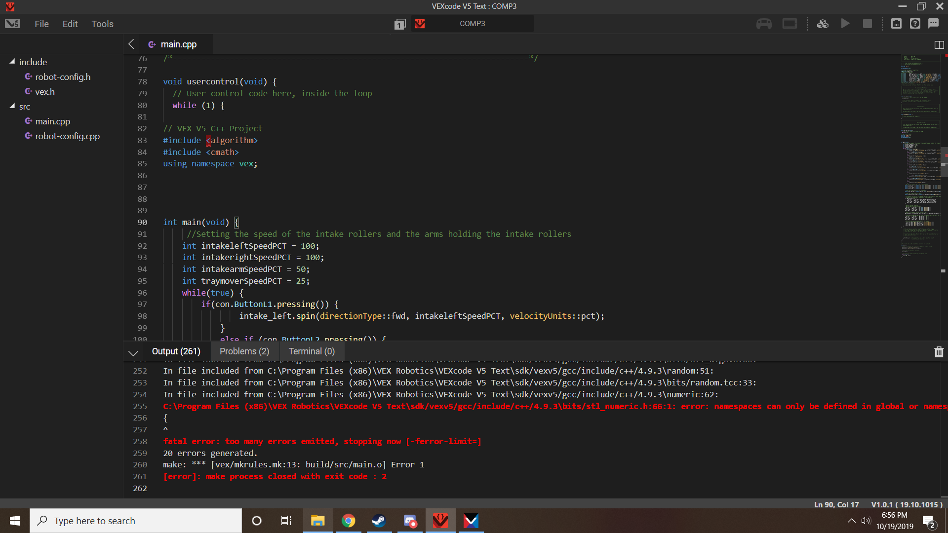

Hi everyone! I am having issues with programming my robot with a competition template. I have tried a lot, but don’t see a switch for drivercontrol. If anyone can spare a working code that has an autonomous section, and a driver control section, that would help a lot! Thanks!
In the standard competition there should be a spot for the user code and a autonomous code, along with a section for things before that.
This is what is has - no spot. Just driver control

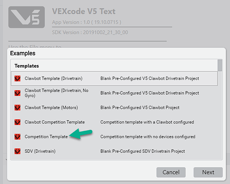

Make sure you’re using the ‘Competition Template’ from File / Open Examples.

Tried this, why am I gettong errors here: “ ” and here: “/----------------------------------------------------------------------------/”

@Deicer , do you know why those are marked as errors?
I can’t tell what the error is on the first line, but in the second one your ‘include’ and ‘namespace’ lines are supposed to be at the top of your file. Unless you moved them they should have already been in the right place.
EDIT: just to add some reasoning in here, those statements are supposed to be called globally. Putting them in your while loop means it doesn’t function for the rest of the file

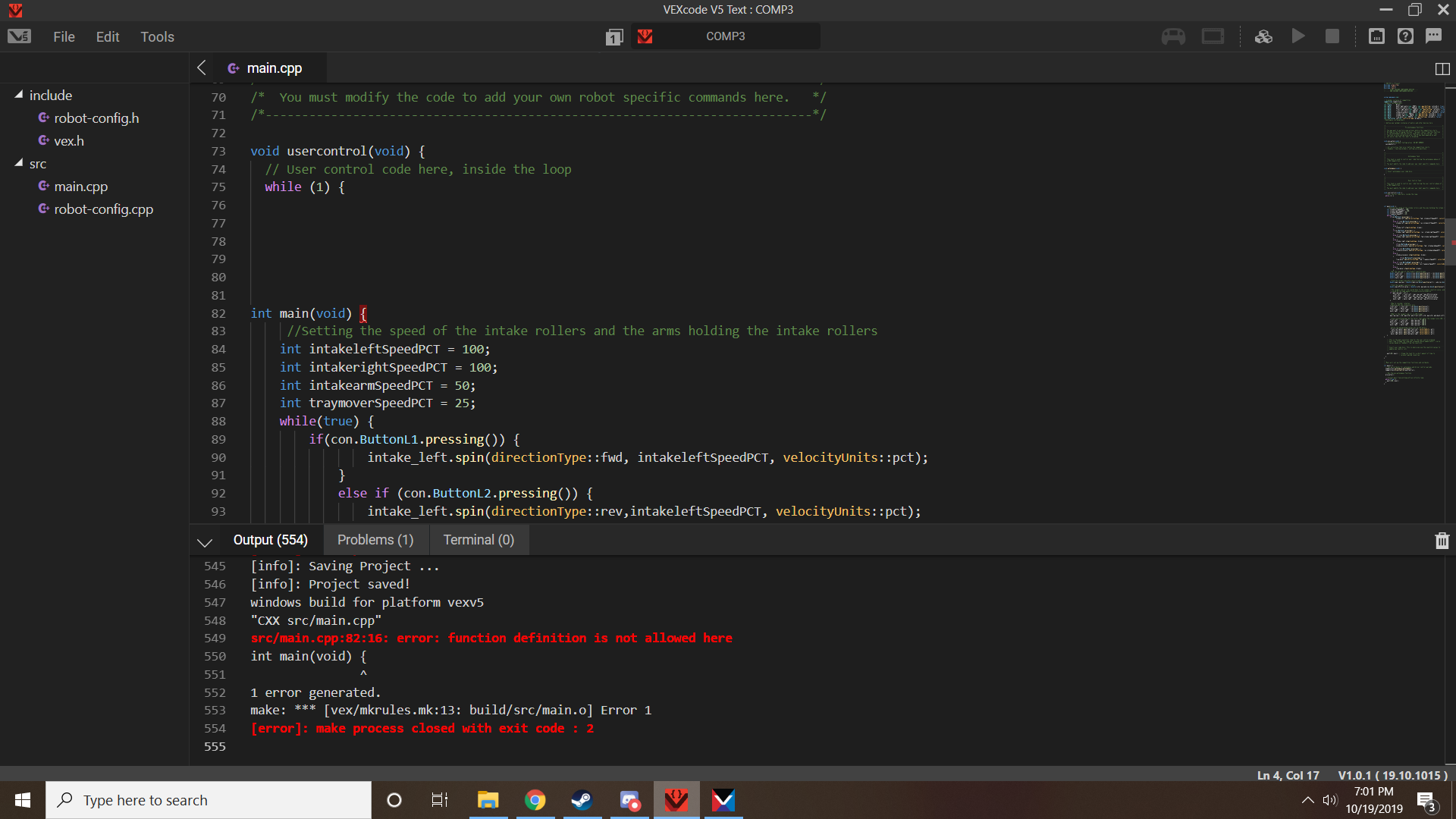

Alright, moved them to the top, and the int main bracket is marked as an error?
Whoops I thought he meant the controls for the robot. Definitely do NOT define the motors in the while loop.
Alright I think I see the big problem here. ‘int main’ defines the ‘main’ function, which is already defined by the template at the bottom of the file. I’m assuming you copied your previous code directly into the user control function, but you can’t define main inside the defining of usercontrol.
Your fix is to take out the ‘int main’ line and its brackets. Also make sure usercontrol has its corresponding end bracket.

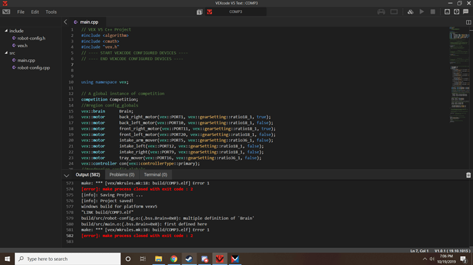

Alright, Thanks! Bad news though, when building, it doesn’t work, but it says there is an error:
Edit: no i dont think i defined brain twice, but there is vex::brain Brain;
You didn’t define brain twice, but it’s already defined by the template in the pesky ‘robot-config.cpp’ file :stuck_out_tongue:
Just delete it in main.cpp and you should be all set!

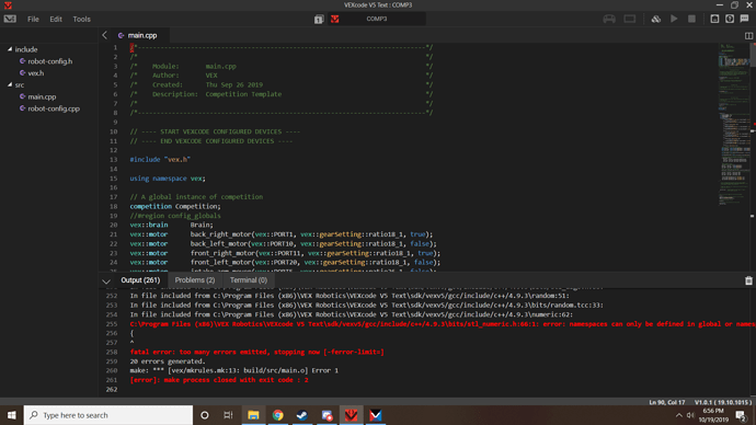

On the left sidebar is a list of files in the project that are uploaded to your robot. The bottom one is ‘robot-config.cpp’, which is where the graphical robot config puts its declarations.
Also, at the top of the code you sent why are there 2 empty '#include’s? (And that third one is missing its semicolon. [;]
Your header is all messed up, idk what happened to it. It should look like this:
/*    Module:       main.cpp                                                  */
/*    Author:       Deicer on the forums lol                                                       */
/*    Created:      Thu Sep 26 2019                                           */
/*    Description:  Competition Template                                      */
// ---- START VEXCODE CONFIGURED DEVICES ----
#include "vex.h"
using namespace vex;
// A global instance of competition
competition Competition;
//insert rest of code here
copypaste it if you want… or just use the template again.
It put the empty includes and they were causing issues so i put them at the top. The header, I dont know what happened, and it works! Thank you so much, I couldnt figure this out!
