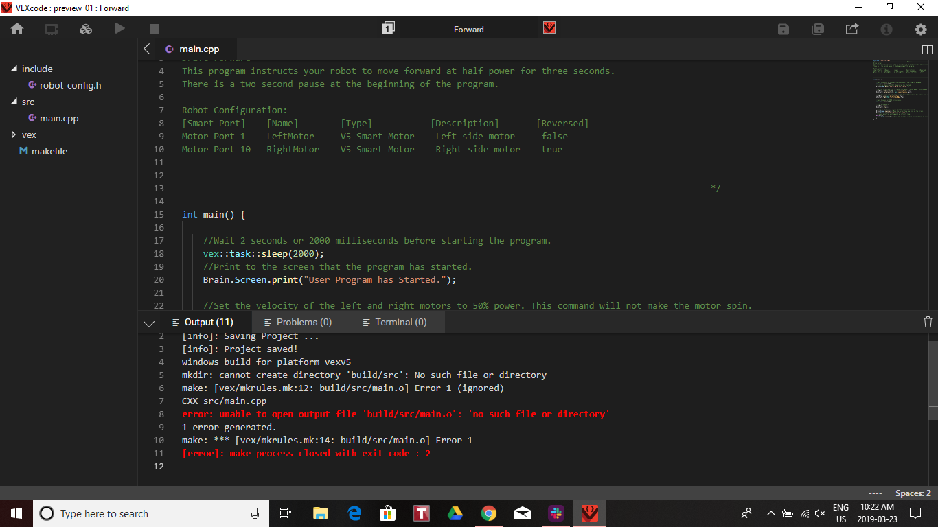

I have just installed the VEX code on my Windows 10 machine and opened the first sample program, “Drive Forward” and compiled it. I received the the following errors.
Go into your project folder and create a new folder called build
3 posts were split to a new topic: VEXcode printf error
