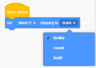

The lift motors could be under too much stress. You may need to enable motor “hold” function when they are stopped (on the software side) and add some elastics to help counteract the force of gravity (on the hardware side).
If the problem still persists, please, attach pictures of your robot and full program code, so it is easier to understand the problem.
