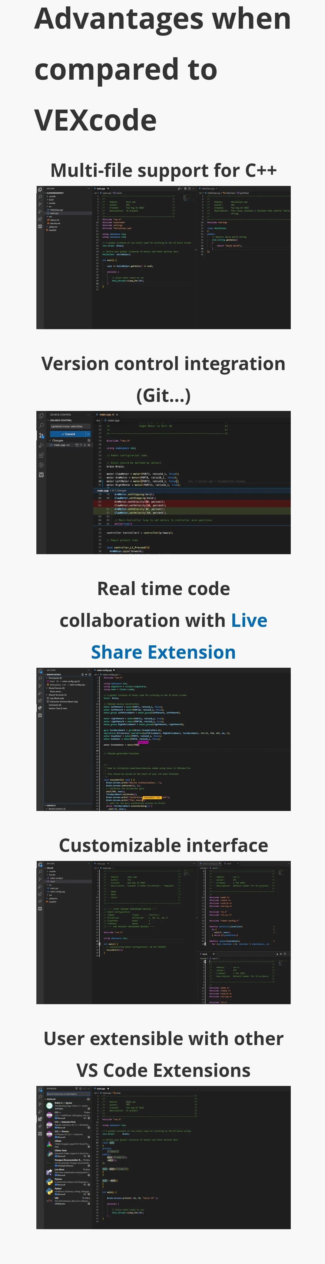

Here are some differences listed on this website between vex code pro v5 and vscode extension. Not sure about the differences between it and pros.Vex vscode extension
