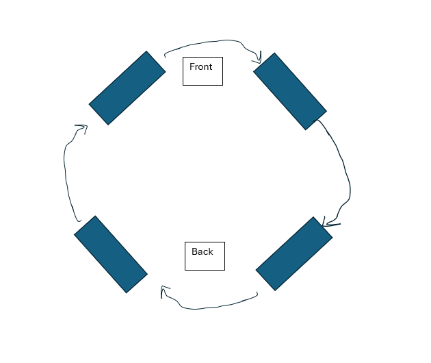

By entering the gear ratio as normal, would distance be the only measurement effected? Should “Turn right 90 degrees” or “Turn to heading 270” still be applicable since those turning motions are completed on a linear turn and not effected by the 45 degree angles?
It’s possible to use the VEXcode drivetrain, it’s just that using it doesn’t let you strafe (go sideways), basically reducing the X-drive to a tank drive. If you set up the drivetrain right, turning would not be affected. (I don’t understand what you mean by a linear turn, can you explain?) The two ways that I can think of to code the autonomous drivetrain movement (not using the VEXcode drivetrain) is to automate the calculation process (from distance to motor movement) with a My Block or to calculate it yourself. I recommend My Blocks because there are less opportunities for mistakes.
I gotcha. Yes, I am not sure our elementary kids have wanted to strafe in their autonomous, or have not seen a need that caused them to want to investigate it from an autonomous programming. So they are using the 4 motor tank drive drivetrain. Below is what I was attempting to communicate that it does when it “turns right” on a linear motion.
