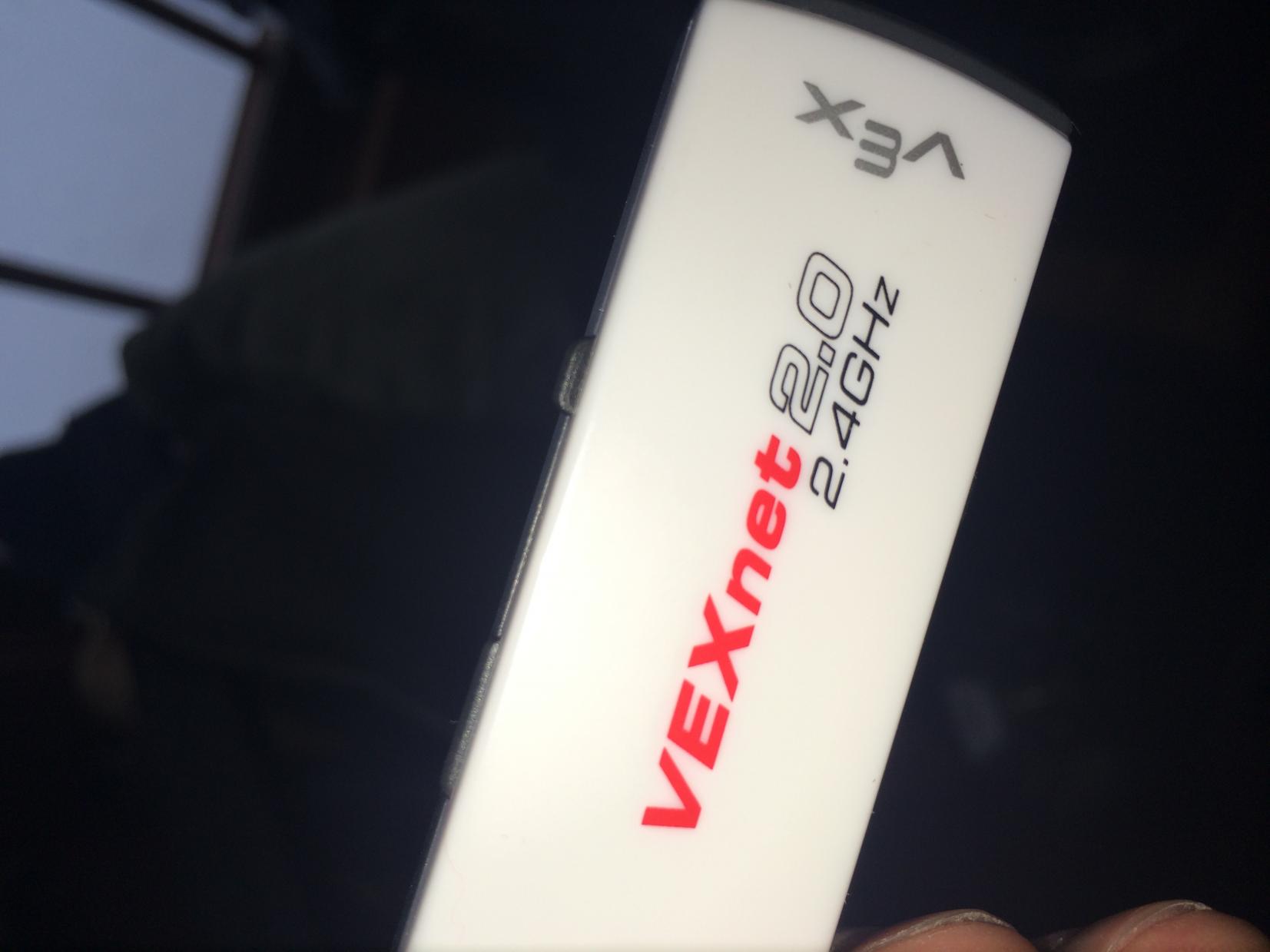

I recieved my vexnet 2.0 keys about a week ago and wanted to share my experience with you. So far they have worked very well.

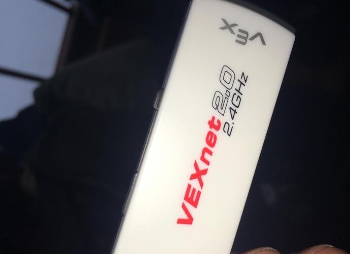

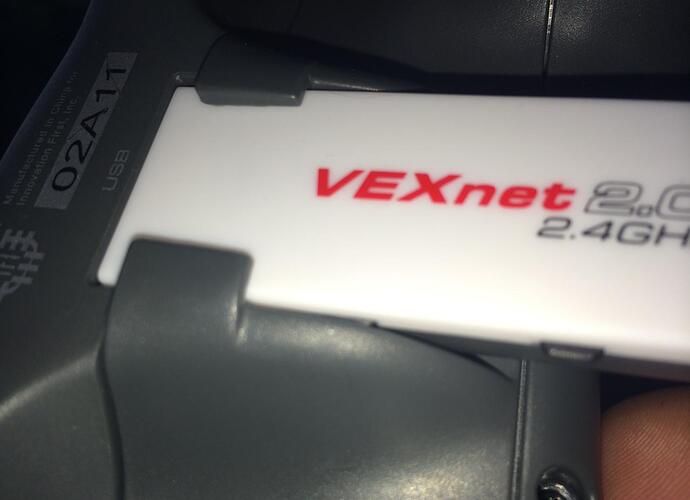

New Retention Mechanism:
The rubber on the sides seems to help to hold the key in the controller much more than it does in the cortex. It holds very firmly in the controller, but the cortex is a different story. It is better than the old keys, but it is still not where i think it should be. There is still a lot of room for the key to move out of the cortex. It is hard to explain, but it is in the direction perpendicular to the direction in which you insert the key. It is more secure but i am still going to tape it in for more security. The attached pictures show the rubber that was added to the new keys to help hold them in.

Overall good update, but still not as good as they could be, but hey there is always room for improvement. The retention still needs some work on the cortex, but it is hard to improve without modification to the cortex which is obviously not a good option. The connection and interference seem to be much improved compare to the previous keys. Good work vex.
[ATTACH]8031[/ATTACH]
[ATTACH]8032[/ATTACH]
[ATTACH]8033[/ATTACH]
I anyone has questions just let me know :slight_smile:
