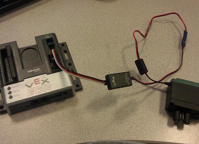

Are you using the Motor Controller 29?
See attachment.
Your motor automatically spins because you are connecting the pins directly into the V+ output.
-Eli
I just figured that out. No I am not using the Motor Controllers, so I will need those.
Thank you :smiley:
