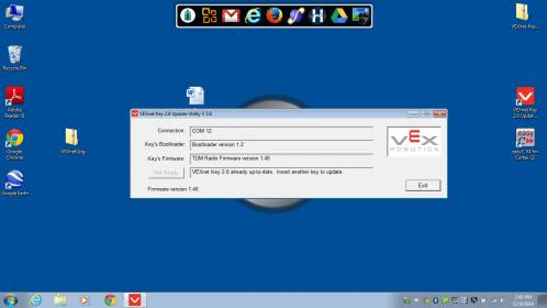

Can you please attach a screenshot of your VEXnet Upgrade Utility and another screenshot of the VEXnet Key 2.0 Upgrade Utility?

Hopefully I’ve successfully attached four images to this reply. The first two are of the keys and the second two images are of the cortex and joystick.

Hi WCSTEMClub,
Based on your screenshots, I can tell (had to squint my eyes:)) you are running an outdated version of the VEXnet Upgrade Utility.
Please make sure you are running VEXnet Upgrade Utility 4.1.5, feel free to download it from here.

YAY! Thanks for the help, as soon as we updated the firmware, we were able to successfully connect the two keys.
