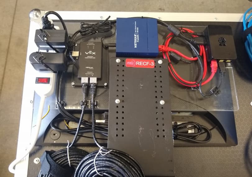

In our setup, we have a plate attached to the back of each field monitor with a 4-socket powerbar, Pi, field controller, and a network switch. Lots of zipties keep “helpful” volunteers from unplugging everything. There is a quick-release VESA mount in there too (thanks lscap), to separate the monitor from the stand for transport/storage.

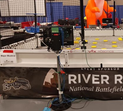

We mount these field monitors on a 36" tall stand separate from the field perimeter. The tall stand works well with raised fields as well as floor-mounted fields.
