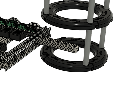

So I have had this Idea for a while, and have decided to bring it to the VEX forum. I thought it might be nice to have a passive descorer on the back of a robot, that could quickly descore the goals. Now, obviously, well built intakes and a pooper would probably be more efficient, but this might be helpful for newer teams.
Here is my thought process of this idea:
I decided that since this would probably take some wear, as it would probably be constantly running into things, so I decided to build it out of boxed U-channel, with some spacer boxing to make it very sturdy. It would use rubber bands to hold itself in place, and probably deploy similar to anti tips in TT. Here is an image in Fusion 360 of it folded up:
Screenshot 2021-03-17 113214
Using 2-wide for a chassis, it is a pretty tight fit- however, that can be fixed by mounting the bracing it would be attached to on spacers, or using 3-wide for a chassis. Here is an image of it folded out:
Screenshot 2021-03-17 112830
It reaches pretty far into the goals, and would make it easy to sweep out.
Thoughts? Ideas? (Constructive) Criticisms?
Looks solid. If anything, I would say that it would just take a decent amount of time (on a tank drive). You have to line up with the goal with the back of your robot and then swipe back and forth.

I agree with the part about the Tank Drive, I modeled it on one because I had designed one to get some more experience earlier. Our robot is on an x-drive, and I think that strafing would make this much more easier to use. I think that having the on the side might make it hard to align with the corner goals, though.

If your intended audience is newer teams, this seems like it may require a high level of build quality to be effective at all.
I mean, not really. it just needs to be sturdy, long enough to reach into the goal, and able to flip out. My CAD model up above is really just to show the concept.

We have this on our robot and it does make quick descoring faster, once you get used to driving it
Edit: To elaborate, our robot could still descore from the intakes, the de-scorer just made it so we wouldn have to turn in some cases. E.G. We could score in an edge goal then back into the center goal and de-score.
I honestly don’t see this being as effective for intakes that can just descore. It would take less effort to get ok intakes and wedges for the goals that will be :100: more efficient.
I agree, but for rookie teams or a team that’s having to rush it’s viable and even competitive with driving practice. It’s by no means ideal but will work in a pinch.
