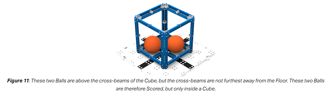

If a cube is placed on a platform with the gird of the cube down, would balls placed inside the cube (on top of the platform) be scored as 1 point or 2 since they are no longer touching the floor of the field?
I believe such balls would not be scored as being on top of a cube, since the criteria include the following provision:
a. The Ball is at least partially above the side of the Cube with cross-beams.
  • The side of the Cube with cross-beams is the side which is furthest away from
    (and roughly parallel to) the Floor.
If the cube is upside-down, the side of the cube with cross-beams is not furthest from the floor, and so no balls can be scored on top of that cube.
However, balls in the position you describe would still meet the criteria to score inside of the cube, and thus would score 1 point each.

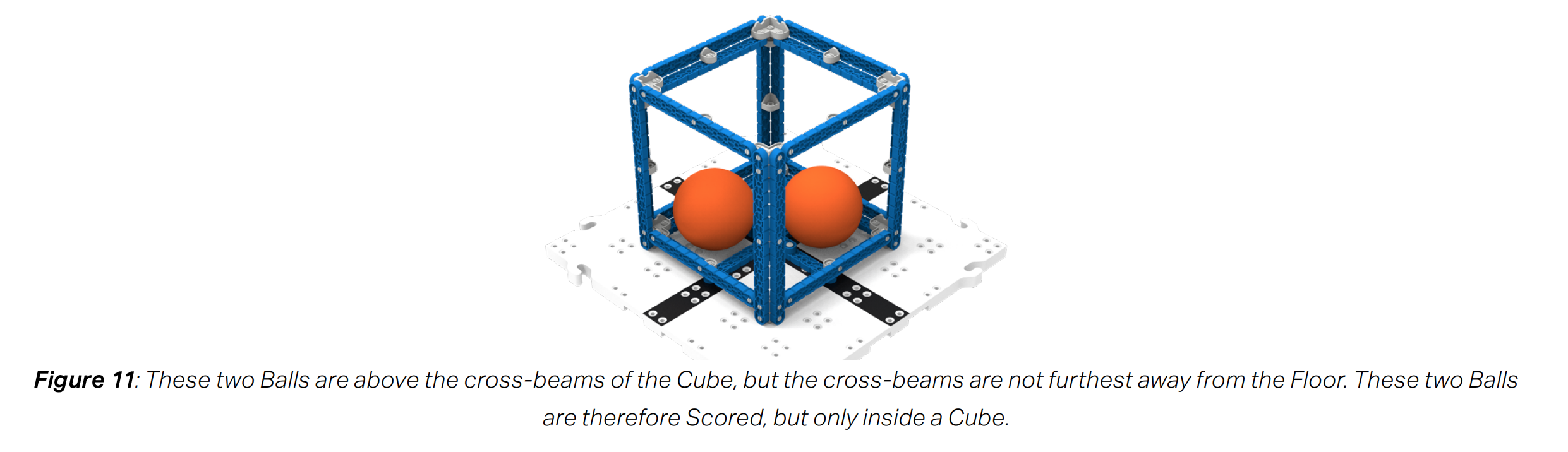

EDIT: This case is actually illustrated by Figure 11 in the game manual:

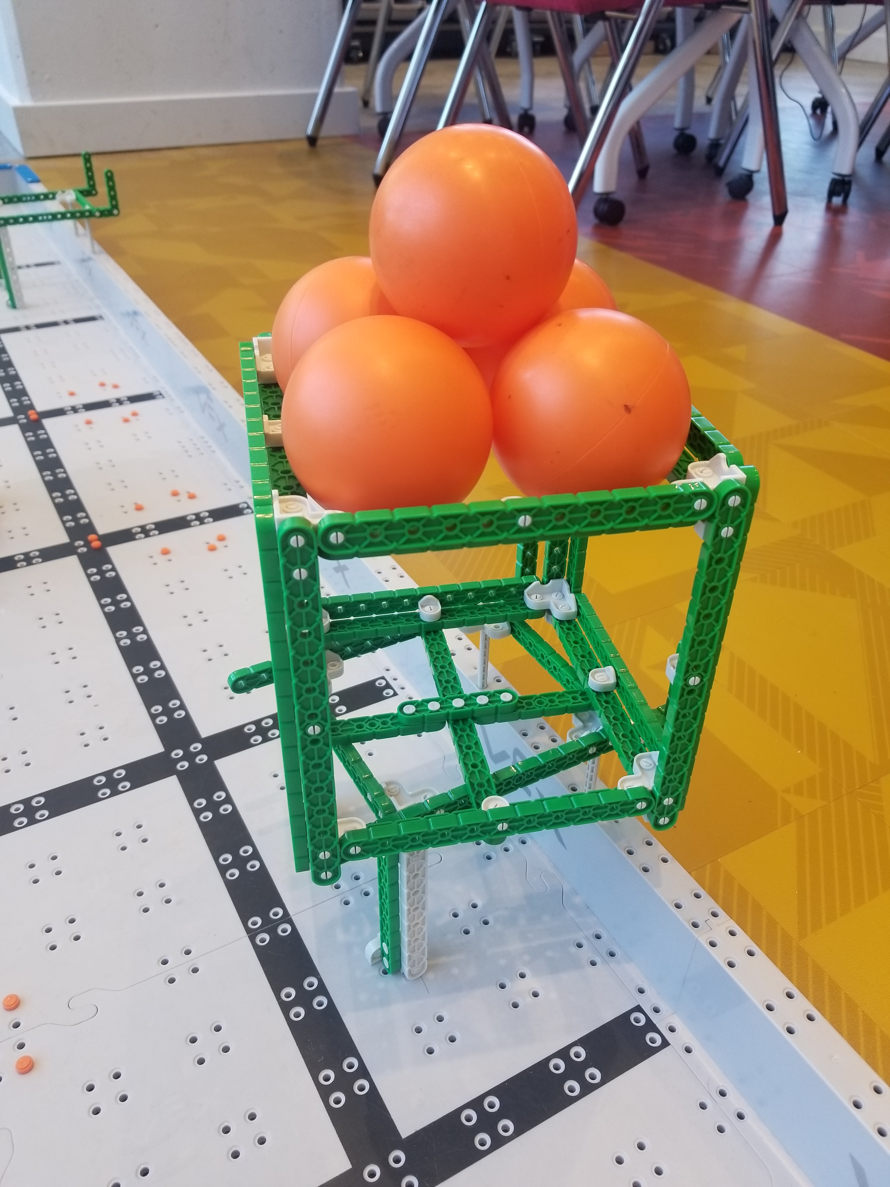

Now if the cube was upside down, I can see that the 4 balls that are breaking the volume of the cube being scored as 1 point each. My question is would the ball on top be scored as 1 point or would it not be scored as it is not breaking the volume of the cube? The rules only mention an infinite vertical projection of a cube for a ball scoring on top of a cube.
20190607_134659%5B1%5D
As far as I can tell, that top ball doesn’t meet any of the criteria for scored.
That is what I believe as well. I just wanted clarification to make sure that we stay consistent on scoring when it comes to the competitions and what I tell my students.
To explain this in more detail, let’s look at the definition of scored:
The top ball in the photo above is not scored inside the cube because criterion 1(a) is not met: The ball is not within the interior volume of the cube. In addition, no balls can be scored on top of this cube because criterion 2(a)(i) is not met. Thus, the top ball is not scored.
But I believe the 4 balls would be technically inside, so 1 point each.
If this ever happens (how!?) then besides the 20 points for cube on tower, perhaps some refs will score 10 points, some 5 points, some 4 points, and some no points (for the balls)…

The max score possible in a current Squared Away game is 170. Taking this account, the only way to obtain that score is for 5 balls to be on top of each of the 7 cubes. The way we see it (and read the rules), that photo above would count for 30 points. 20 for the green cube legally positioned on the stand plus 2 points for each of the 5 balls on top of the cube.
Take a look at my reply above - a careful reading of the definition of scored reveals that the bottom 4 balls are scored inside the cube, and the top ball isn’t scored at all. Thus that configuration scores 24 points.
If that cube were spun 180 degrees, so that the side with the cross beams was the farthest side from the floor, then all 5 balls would be scored on top, and your count of 30 points would be correct.
