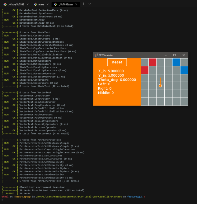

I’ve spent about 90% of my time programming for VEX away from the robot.
This is because I mostly work on higher level algorithms and such, which aren’t necessarily specific to a VEX robot. This means I can run and test the code on my computer, and then I only need to test on the robot once it is complete.
For example, I used a canvas drawing API (you can use any, I used js canvas) to work on my pure pursuit path following algorithm:
Then, when it was time to write it for the robot, I just had to copy and paste already tested code.
These days, I’m working on code to generate trajectories, and for that I use python’s matplotlib to generate graph visualizations of the program.
However, your question was about testing an autonomous selector. If you use VEXCode, you can use RMS mimic to simulate the screen. If you use PROS & LVGL, you can run your LVGL selection code on any device including your computer:
