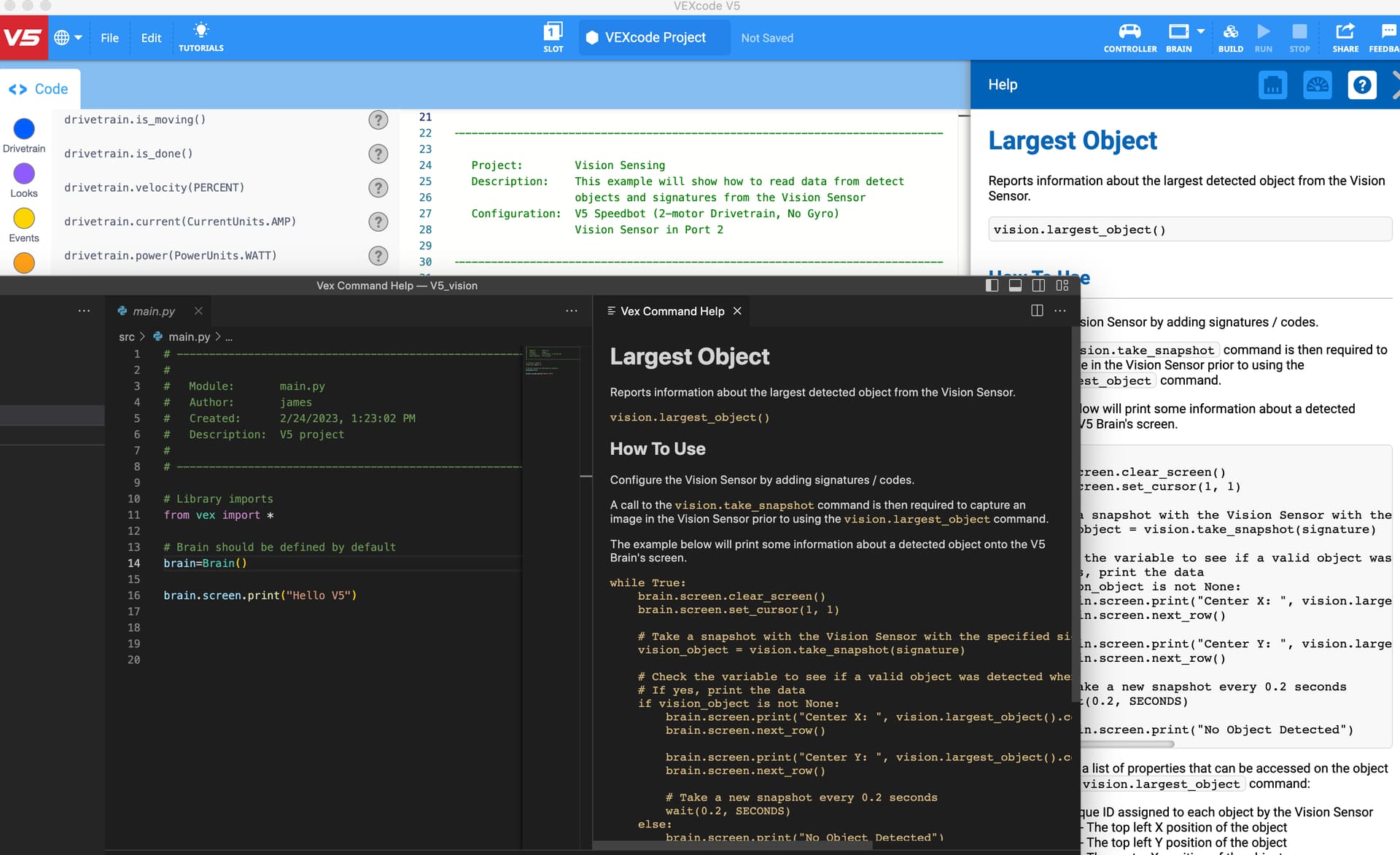

there are only two methods, take_snapshot, which returns a tuple of vision objects, and largest_object.
see help and intelisense in the VScode extension for more details.

There’s no connection between the PROS C++ API and the VEXcode C++ API, why would you expect the, now obsolete and unsupported, RobotMesh Python API to be the same as the VEX Python API. We’ve said many times, the help docs are built into VEXcode and the VSCode extension, as well as many examples of their use.

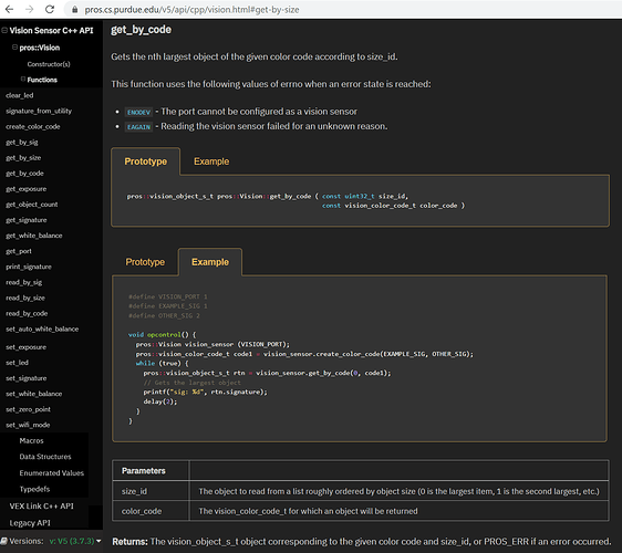

If you look at the source code for any official V5 API page (for example, api.vexcode.cloud/v5/class/classvex_1_1motor), you will see no search engine indexable content, just a few JavaScripts that, I guess, dynamically pull content from some sort of internal database:
I though it was automatically generated from the source code, but there are counterexamples:
Overall, compared to the excellent PROS online documentation, api.vexcode.cloud is missing meaningful descriptions, code examples, and hyperlinks:
The question is why couldn’t V5 online help be updated to have, at least, content similar to that already available inside the app?

The info at the link is the same help found in VEXcode, there are one or two classes referred to that do not apply to the V5 (specifically vr_thread) or the VS Code environment (calibrate_drivetrain() which is an auto generated function in VEXcode only).
