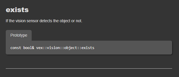

hi i need help with the exists function in the vision sensor class.
im talking about this:
when i use the function theres an error:
im stupid, can you help me?
You need to add an object to the code. If you are looking for the largest object it would be
VS.largestObject.exists()
exists() is for vision objects, not the sensor itself. You probably want to do something like
This isn’t necessarily super important, but you shouldn’t use a comparison to false. Just use something like
if (!VS.largestObject.exists()) {
