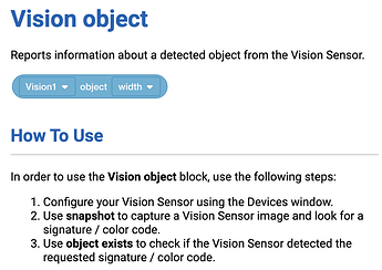

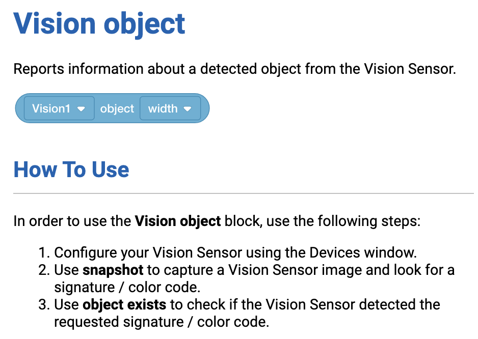

To use that command / block you need to do the following:
You can use help inside VEXcode for more documentation.
