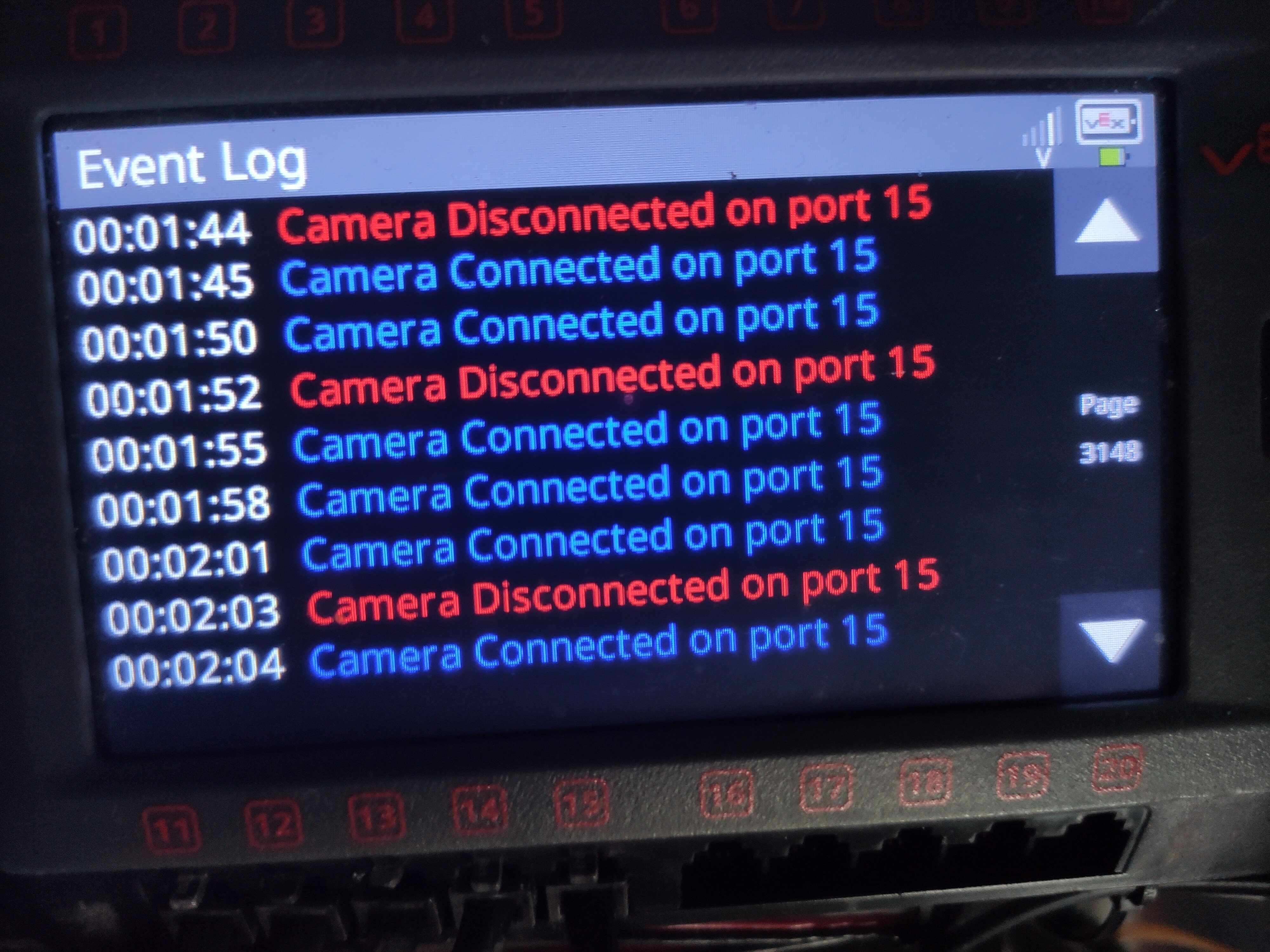

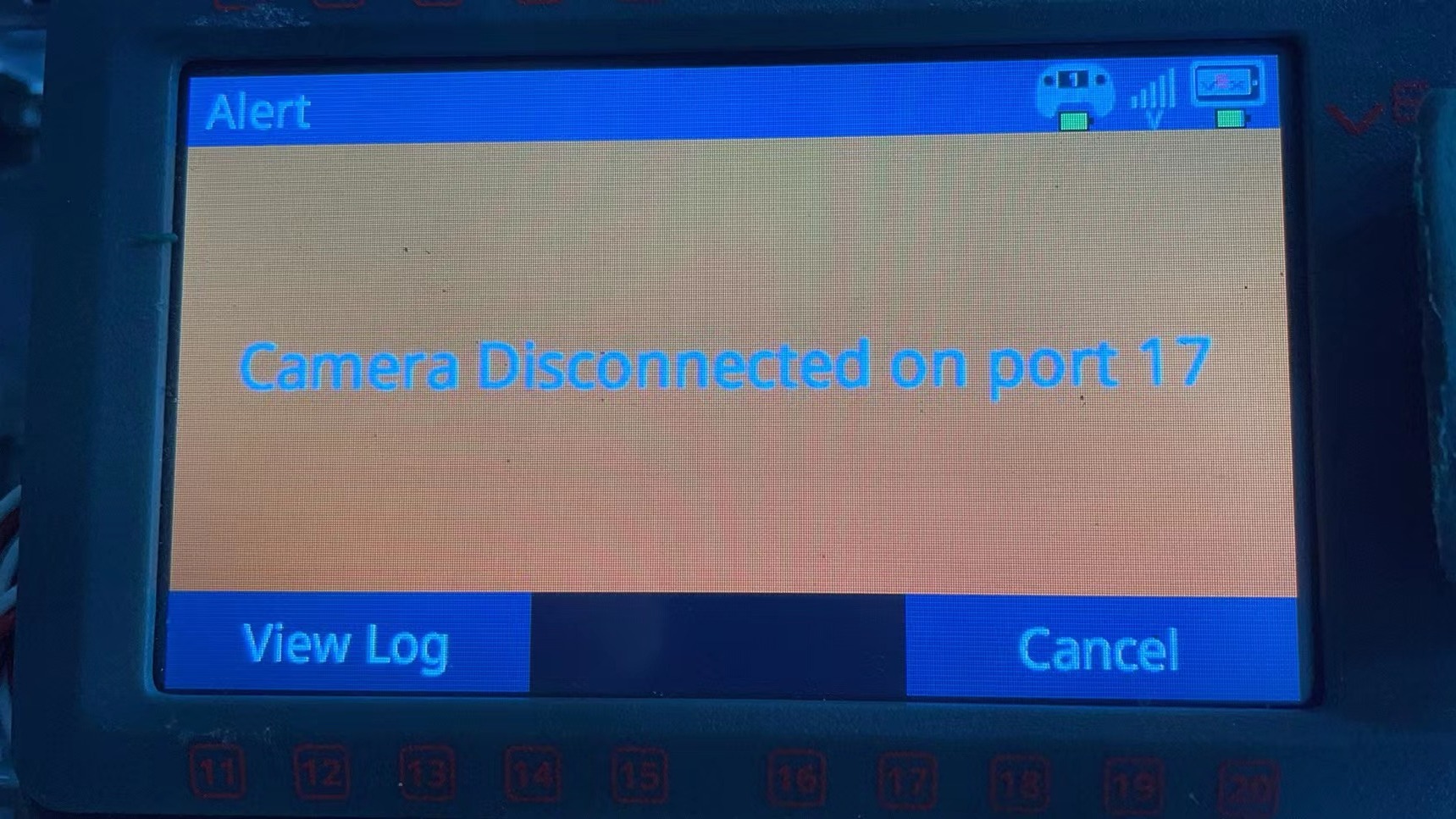

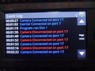

We only ran for a few minutes and the vision sensor disconnected three times.

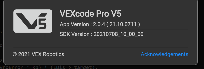

Our master uses the latest version of vexos.
Also, I remember very clearly, we didn’t have the same problem with vision sensors in past Change Up seasons.
Vision sensors have been disconnecting and reconnecting from time to time this season, and all 7 of our bots here have the same problem, even worse than the one in the picture.

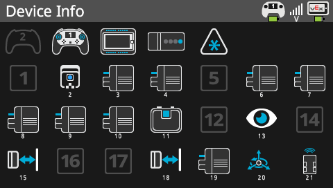

Well, I ran this with a more highly configured system for several hours with no disconnections.
This was the system config.
gps_test9

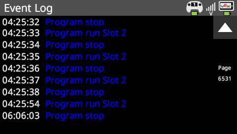

log after running code for ~100 minutes.
gps_test7

We use the latest version of VEXcode Pro.

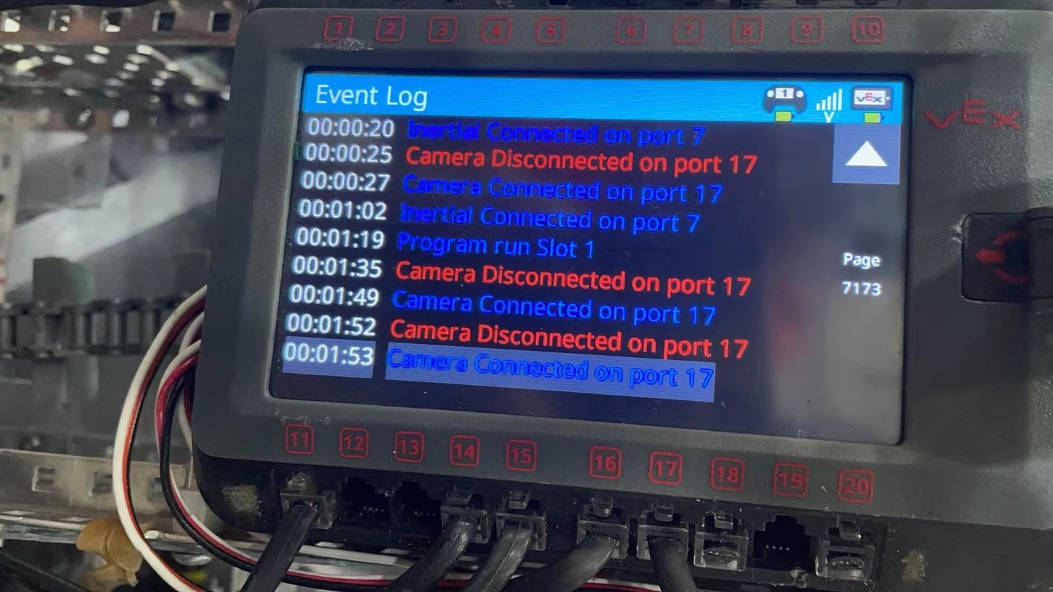

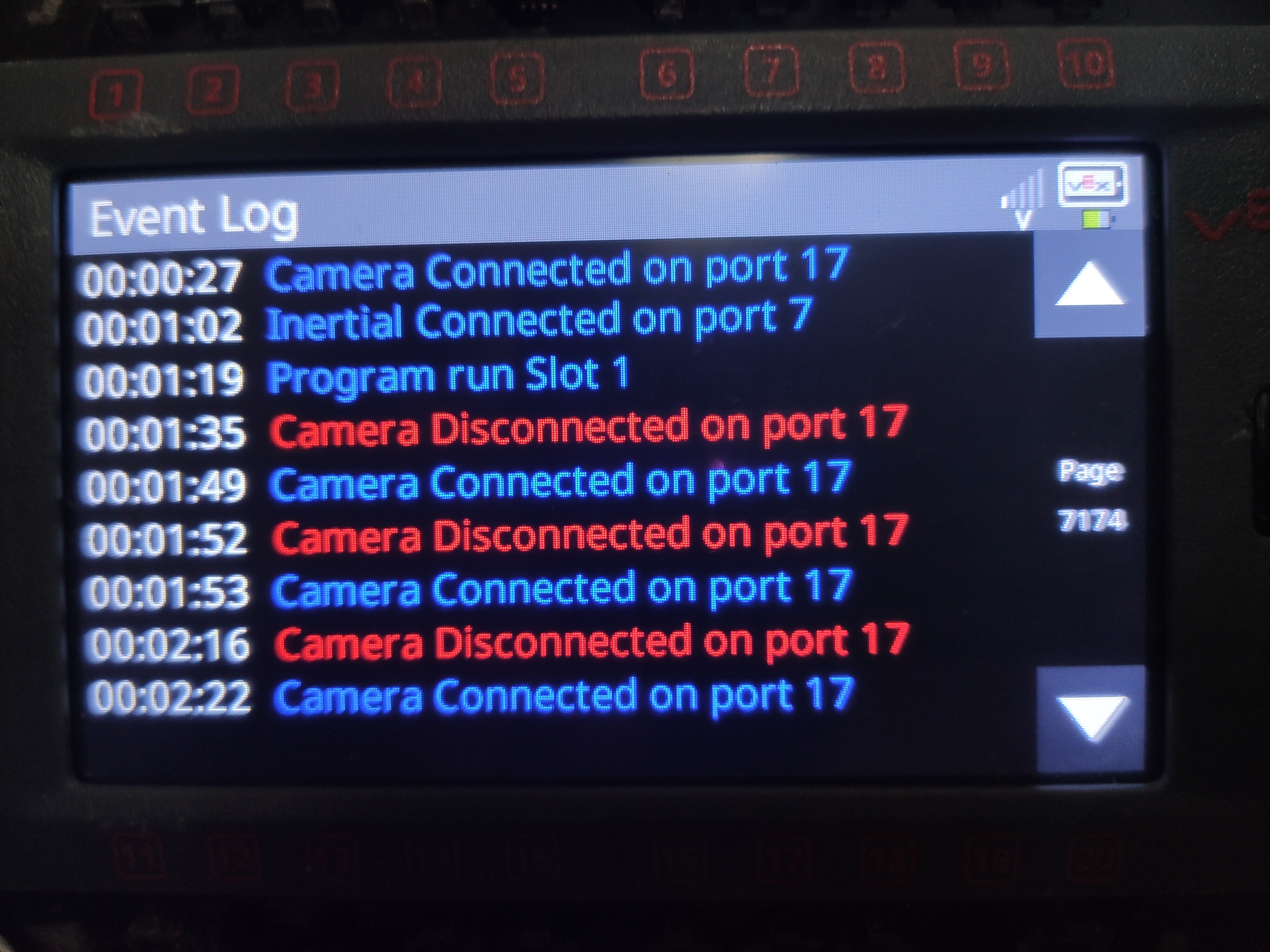

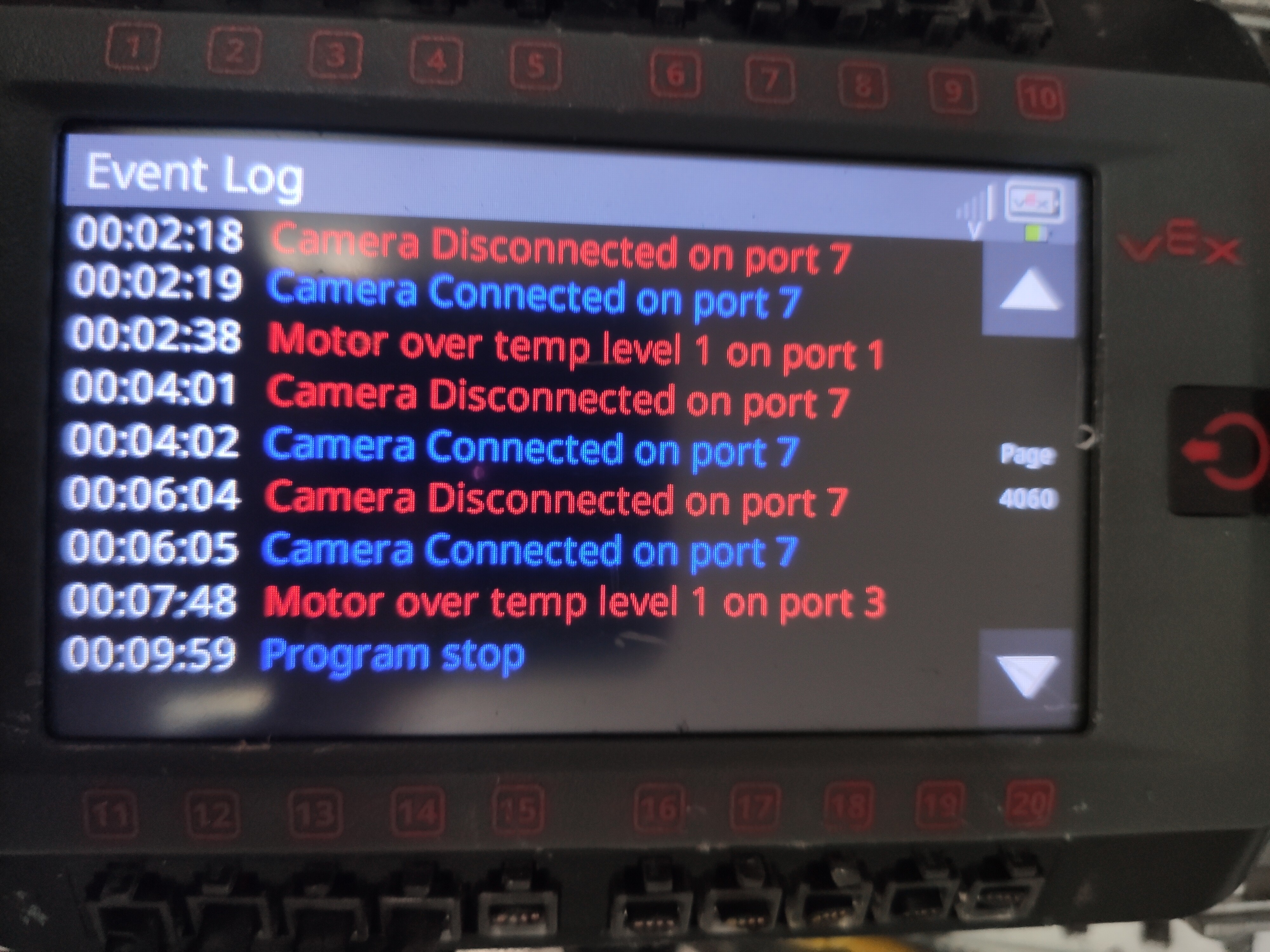

I just rechecked the logs for 7 of the bots using the same code, 4 of them have their vision sensors disconnected all the time, I also rechecked the cables and ports on these 4 bots and everything works is normal.
I don’t know what to tell you, I cannot reproduce the problem, I ran for over 4 hours with no disconnects…

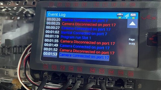

I still don’t see disconnect issues in the way you are, the only way I could occasionally get the camera to disconnect was to move to the dashboard screens and/or the log display screen while the program was running. This would very occasionally cause a disconnect, but not anywhere near the frequency you seem to indicate.
The code you sent me is also sending many messages to the vision sensor LED, that may make things a little worse, although I tried with and without LED messages and any difference was marginal. You could try removing the LED messages and see if that improves things.
Having dug into this we did file a couple of small improvements we can make for the next vexos release, most of the vision communication code was written back in 2017, so none of this should be directly related to the 1.1.0 version. The next vexos will probably be released sometime in the next 2 to 4 weeks.

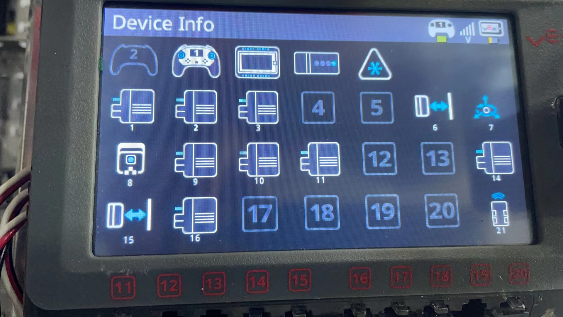

You have a stack of three wire sensors on the brain (I can see at least three sets of wires) What are those sensors?

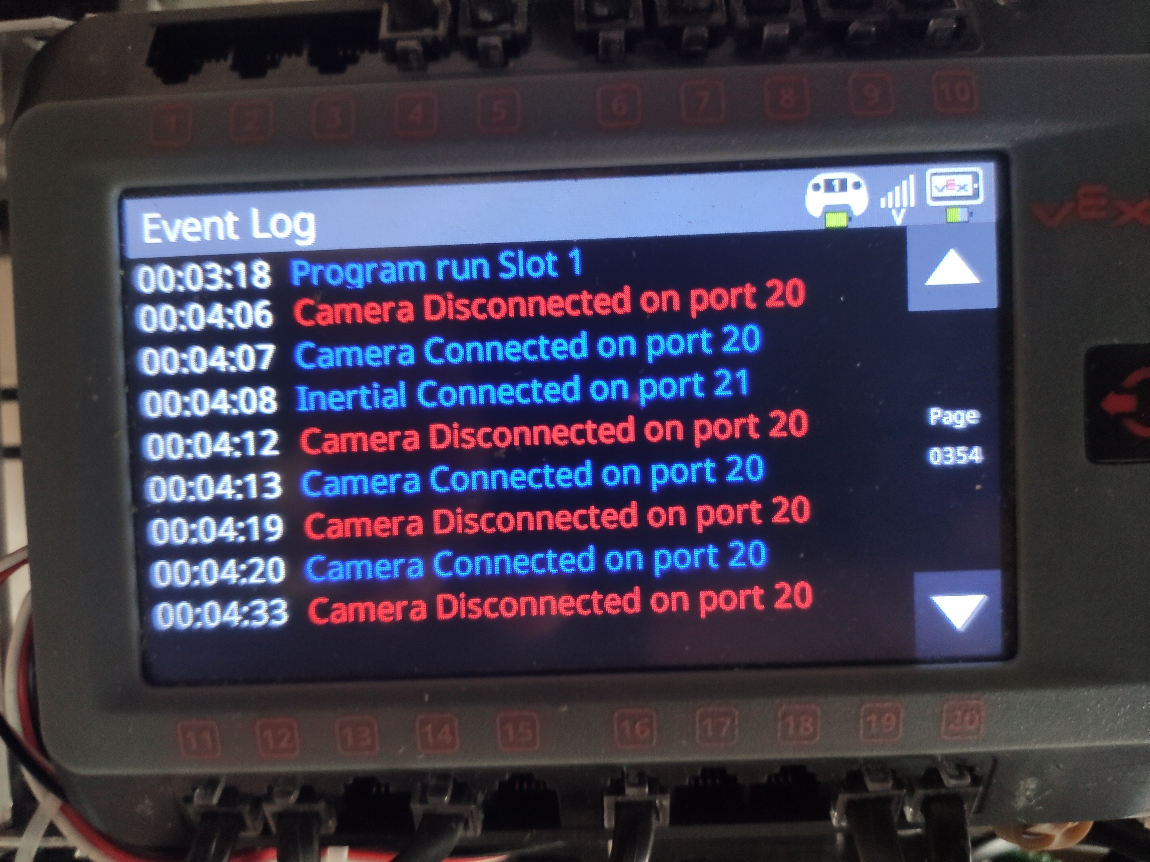

And, our team retain all the robots at the time of the Change Up season and I test the visual sensor in them above.
That is the indicator and pneumatic.
