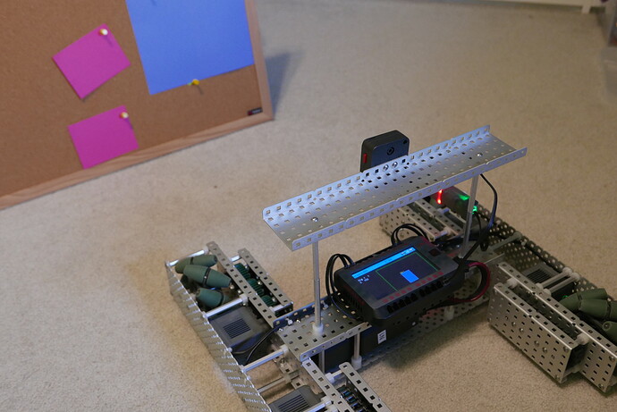

I had a play around today with the vision sensor on one of my old demo robots. The goal was just to test some simple targeting code that could be used as a basis for a more complex program. The robot setup looks like this.
P1050576
I obviously have a large target, but the concept would be the same no matter what size although the code would need to filter out more noise (meaning removing small intermittent objects) with something less well defined. I have the vision sensor mounted sideways so as the robot rotates the detected object will move vertically in the field of view. The targeting code looks like this.

I trigger on a button, that’s why the function is called eventButtonY.
The code runs in a loop, I grab the latest objects found by the vision sensor, check we have at least one and it is large enough. Then there is a simple P loop trying to place the center of the object at a particular location in the field of view.
