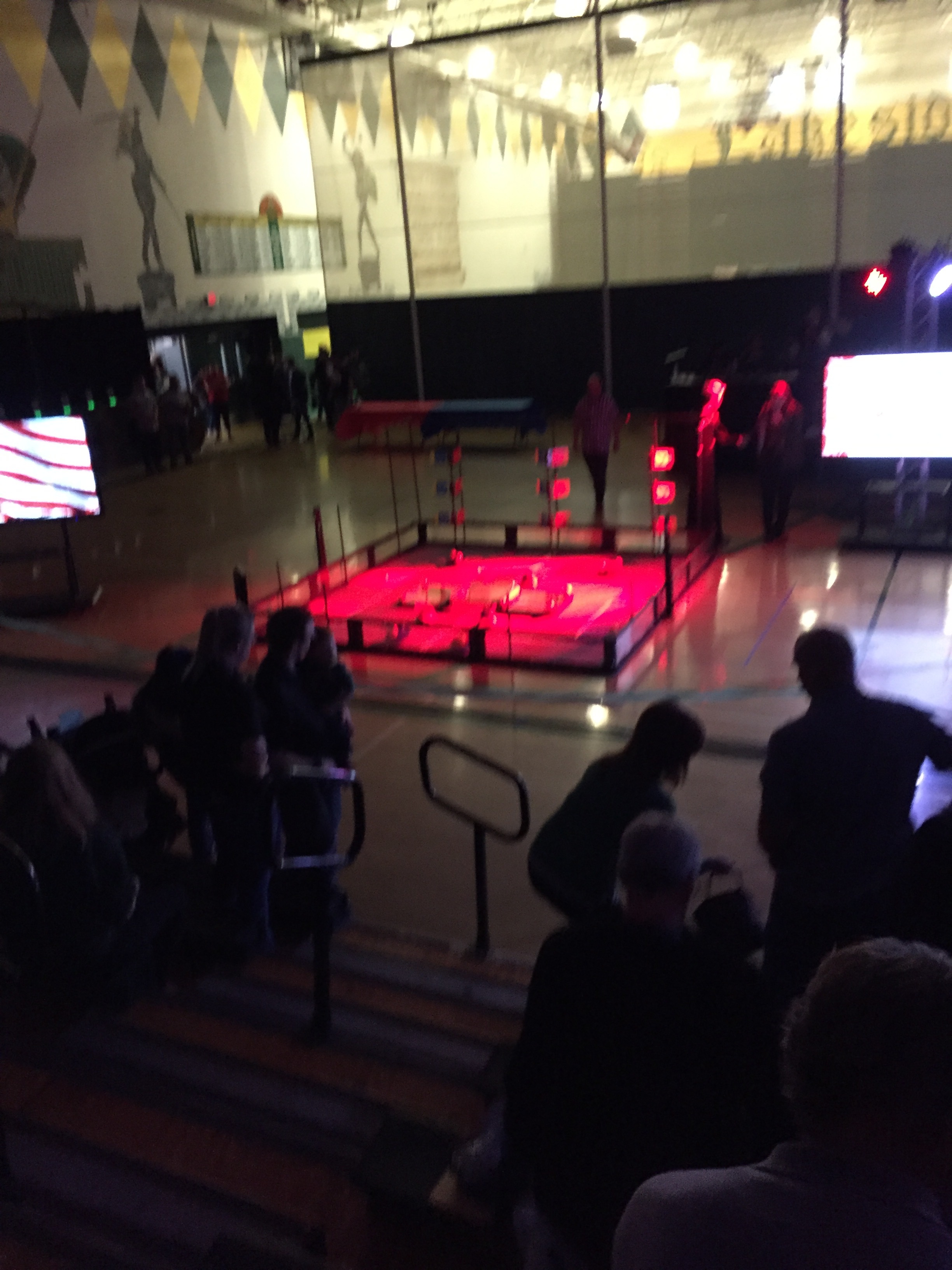

and especially when the lighting conditions make each flag have a unique shade of red, even the blue ones:
7266C38E-8A7A-4C00-928B-EB29F3E94A65
YES!:confounded:This exact thing happened at a tournament earlier this season. Thankfully nobody was utilizing the sensor (at least not well enough for it to make a difference).
idk why they do stuff like that, it makes it harder for everyone. I actually got headaches while driving.

Xenon_27 - glossy surfaces are mirrors. Just because your arena camera sees red, doesn’t mean the robot camera will. The arena camera sees the red of the floor because it’s looking downward. Robot cameras will be looking level or upward, so the (hopefully dark) roof and room will be the reflection. True, it might make sense to design field parts without such glossy surfaces, to encourage use of vision. Frankly, the best environment for vision is a white, diffuse-lluminated ceiling, not a dark room with downlighting. Torcheres!

It would be nice if vex released guidelines on the types of lights allowed to light fields. “Standard white of any temperature are allowed. No colored lights may be used to illuminate the fields during regulation matches,” or something to that effect. Is that so hard?
