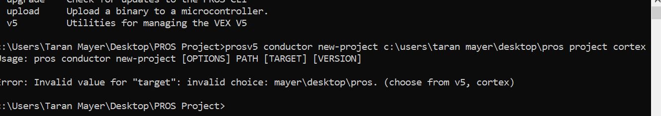

I do that, and get this: Capture
The spaces in your path are causing problems. You need to enclose your path with quotation marks.
No that’s not true you need an underscore between “pros project” it is reading it as only \pros because of the space
If you read the error you will notice it is looking for the path …\pros which doesn’t exist because of that space

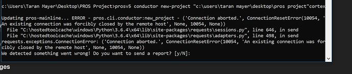

This is happening now: Capture
Press n and enter. Fbsbx zn (20 char(

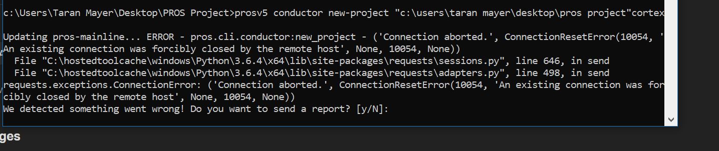

Did it, got the same error message
Post screenshot
