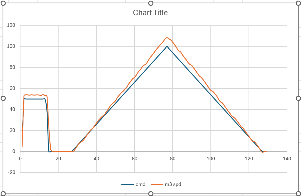

At max input speed (ie what you program) you will get more output speed using volts for sure. This is generally only about 10% for a motor by itself so the question is whether that really makes a difference to you or not. The rest of the picture is more complicated:
  • what you get a lower speeds will either be above or below the speed you request
  • each motor will be different
e.g. here is a motor sitting on my desk by itself with a quick test that runs at 50% voltage (100% would be 10.9v) for a few seconds and then ramps up to 100% voltage and back down to zero (blue line is what im’ telling the motor to do and orange line is what its doing)
Hope this helps …
